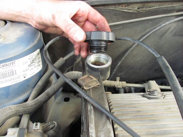

  2. 1997-2003 Chevrolet Malibu Fluid Check, Power Steering Fluid: crwdns2935265:02crwdnd2935265:01crwdnd2935265:03crwdne2935265:0 1997-2003 Chevrolet Malibu Fluid Check, Power Steering Fluid: crwdns2935265:02crwdnd2935265:02crwdnd2935265:03crwdne2935265:0 1997-2003 Chevrolet Malibu Fluid Check, Power Steering Fluid: crwdns2935265:02crwdnd2935265:03crwdnd2935265:03crwdne2935265:0
    • Do not overfill the power steering fluid reservoir, as this can overwork the power steering pump and cause it to burn up.
    • Remove the power steering fluid cap. Check the fluid level using the dipstick attached to the cap.
    • Fill the power steering fluid to the appropriate level indicated by the "H" for hot and the "C" for cold.

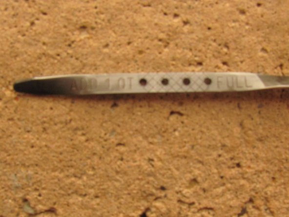

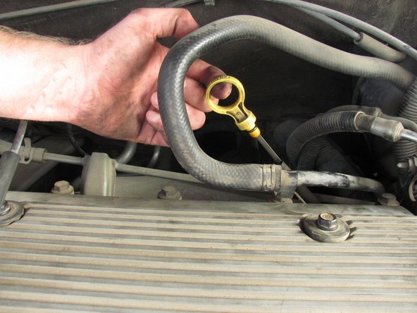

  3. 1997-2003 Chevrolet Malibu Fluid Check, Engine Oil: crwdns2935265:03crwdnd2935265:01crwdnd2935265:03crwdne2935265:0 1997-2003 Chevrolet Malibu Fluid Check, Engine Oil: crwdns2935265:03crwdnd2935265:02crwdnd2935265:03crwdne2935265:0 1997-2003 Chevrolet Malibu Fluid Check, Engine Oil: crwdns2935265:03crwdnd2935265:03crwdnd2935265:03crwdne2935265:0
    • Use the yellow handled oil dipstick to check the oil level by removing the dipstick, wiping off the oil, and re-inserting it.
    • Remove the dipstick again and check the oil level. Full level is read on the right side of the dipstick.

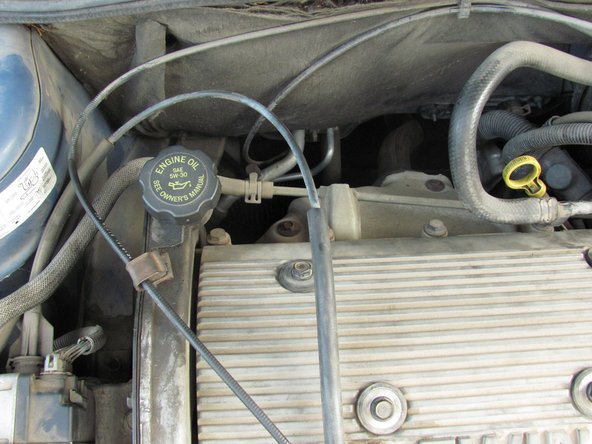

  4. 1997-2003 Chevrolet Malibu Fluid Check, Engine Oil Continued: crwdns2935265:04crwdnd2935265:01crwdnd2935265:03crwdne2935265:0 1997-2003 Chevrolet Malibu Fluid Check, Engine Oil Continued: crwdns2935265:04crwdnd2935265:02crwdnd2935265:03crwdne2935265:0 1997-2003 Chevrolet Malibu Fluid Check, Engine Oil Continued: crwdns2935265:04crwdnd2935265:03crwdnd2935265:03crwdne2935265:0
    • If the oil level is below full, add oil to the car by removing the cap labeled "Engine Oil."
    • Add a small amount of oil and repeat Step 3 until the oil level is full.

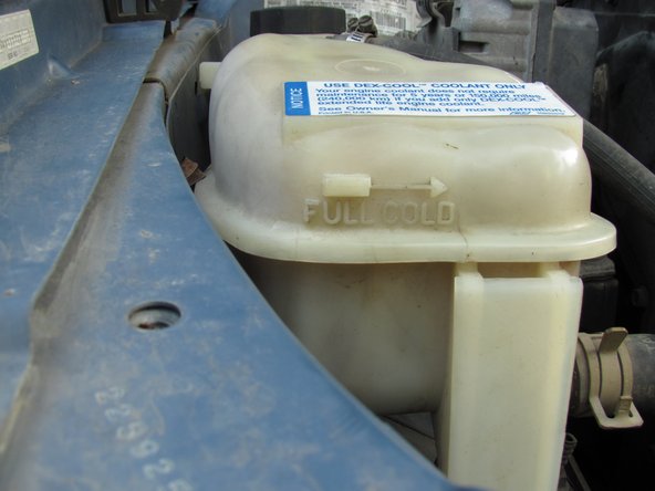

  5. 1997-2003 Chevrolet Malibu Fluid Check, Radiator Coolant Resrvoir: crwdns2935265:05crwdnd2935265:01crwdnd2935265:03crwdne2935265:0 1997-2003 Chevrolet Malibu Fluid Check, Radiator Coolant Resrvoir: crwdns2935265:05crwdnd2935265:02crwdnd2935265:03crwdne2935265:0 1997-2003 Chevrolet Malibu Fluid Check, Radiator Coolant Resrvoir: crwdns2935265:05crwdnd2935265:03crwdnd2935265:03crwdne2935265:0
    • Make sure the engine is cool before removing the radiator reservoir cap. Radiator coolant needs to be disposed of properly. Visit this link for more information http://www.epa.gov/osw/conserve/material...
    • Remove the radiator reservoir cap and fill it with coolant until it reaches the full level indicator line on the front side of the reservoir.
