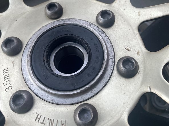

  4. 1996 Honda CBR900RR FireBlade Wheel Bearing Replacement: crwdns2935265:04crwdnd2935265:01crwdnd2935265:01crwdne2935265:0
    • Gently pry the seal from the bearing race.
    • Flip the wheel over and repeat on the other seal.

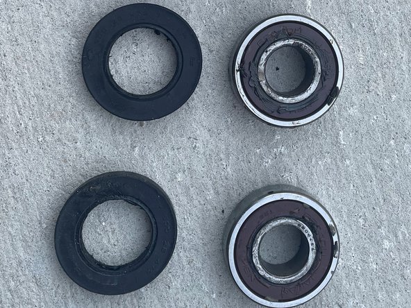

  5. 1996 Honda CBR900RR FireBlade Wheel Bearing Replacement: crwdns2935265:05crwdnd2935265:01crwdnd2935265:02crwdne2935265:0 1996 Honda CBR900RR FireBlade Wheel Bearing Replacement: crwdns2935265:05crwdnd2935265:02crwdnd2935265:02crwdne2935265:0
    • Using the long 3/8" extension, and inserting it at an angle as shown, you should be able to move the bearing spacer to the side and catch the inside of the bearing.
    • Once the extension is firmly planted on the bearing, use the hammer to tap the bearing downward, out of the race.
    • The bearing spacer will fall out.
    • Flip the wheel over and drive the other bearing out with the extension.
