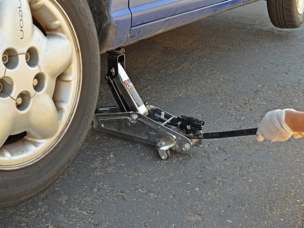

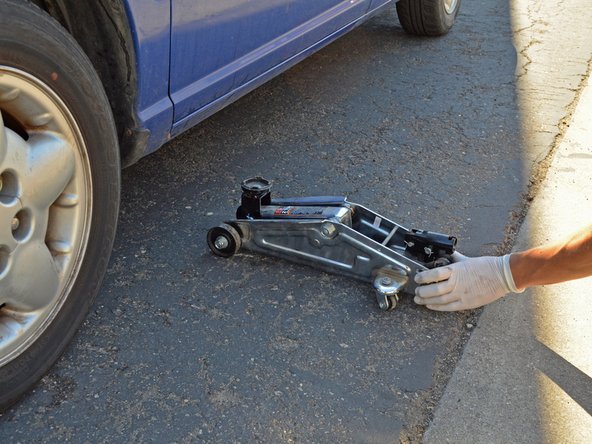

    • Begin jacking up the front driver's side corner of the car by placing a jack between the two notches towards the front of the car on the long vertical part of the frame.
    • It is helpful, but not necessary, to jack both sides of the car. Since the oil drain plug drains slightly to the passenger side of the vehicle centerline, jacking up just the driver's side is sufficient.

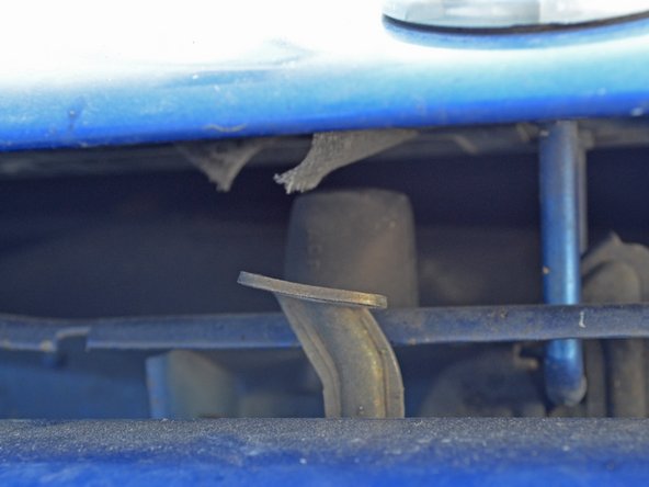

    • Slide the jack stand under the car, slightly left of the jack where the metal is still reinforced, and raise it as high as it goes before hitting the frame.
    • You can release the jack and let the car rest on the jack stand, but we prefer to leave the jack in the reinforced area with the jack stand in place as a fail-safe.

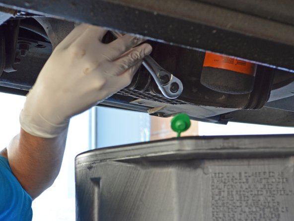

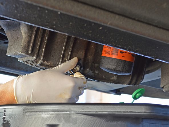

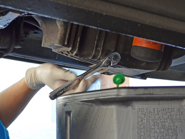

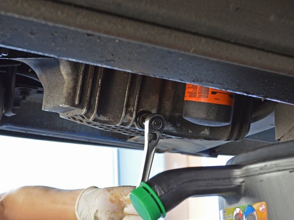

    • Slide a 13 mm socket over the oil drain plug.
    • Use a ratcheting socket wrench to loosen the oil drain plug to the point that you can remove it with your fingers.

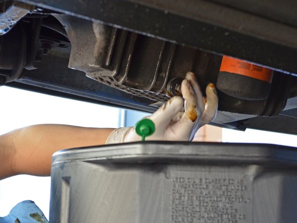

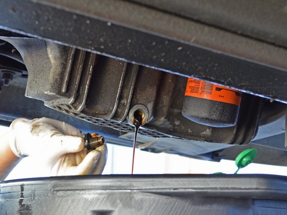

    • Use your fingers to finish unscrewing the oil drain plug.
    • Remove it and allow the old oil to drain into the oil drain pan.
    • Watch the draining oil for shiny specks. Metal flakes in the oil could mean that there is a serious problem with the internals of your engine.

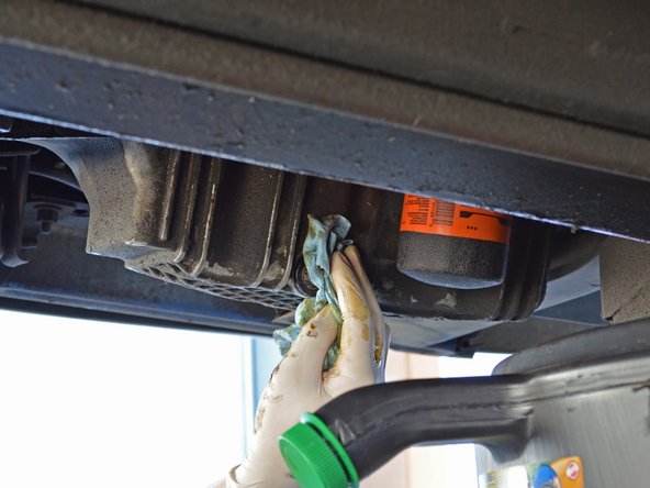

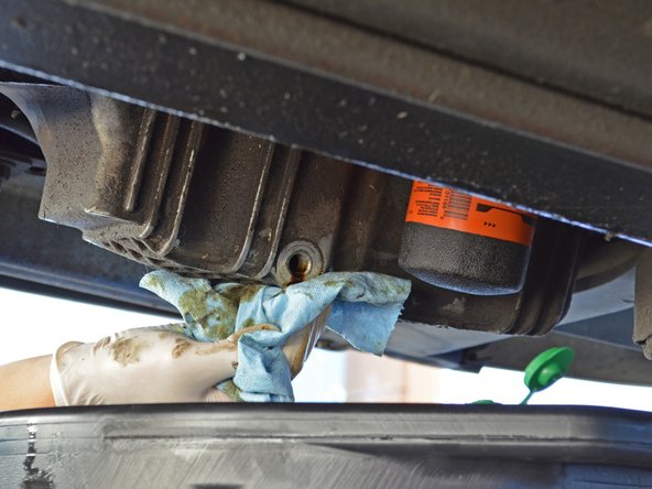

    • Once the old oil has slowed to a drip, use a rag or towel to clean the excess oil from the drain hole.
    • Reinsert the oil drain plug and tighten it with your fingers.
    • Only tighten the oil drain plug enough that it holds in dripping oil. You will remove it again, shortly.

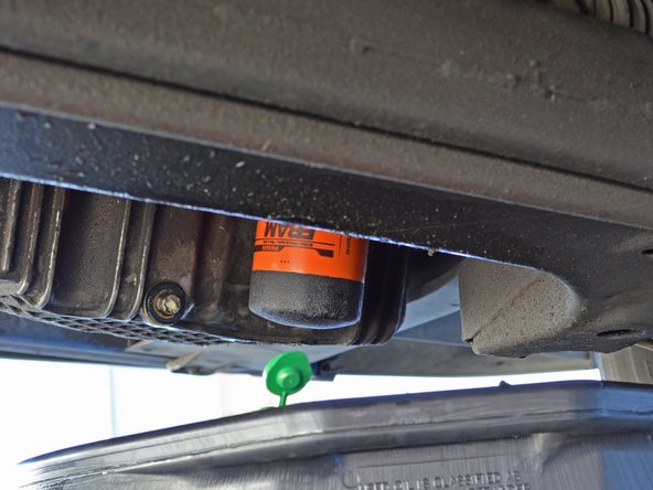

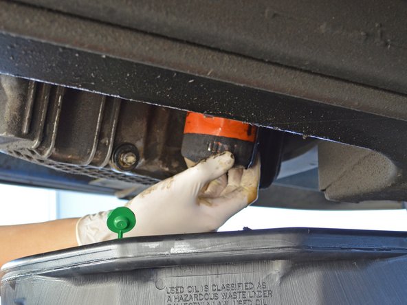

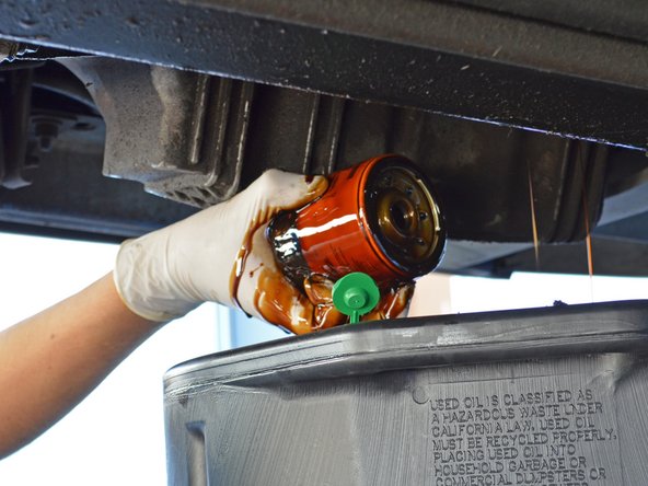

    • Locate the oil filter. It should be facing downwards next to the oil drain plug.
    • Use an oil filter wrench to loosen the oil filter by twisting it counter-clockwise.
    • Once the filter is loosened, use your hand to remove it completely.
    • Allow the oil to drain from the oil filter and the oil filter hole.

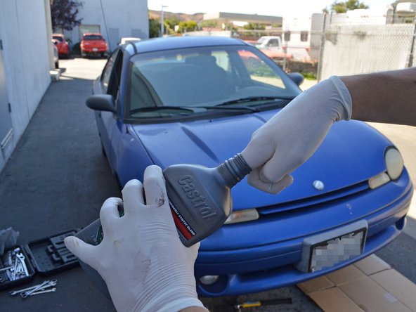

    • Fill the new oil filter about halfway full with new 5W-30 oil.
    • Dip your finger into the new oil and spread a thin layer over the rubber gasket on the filter.

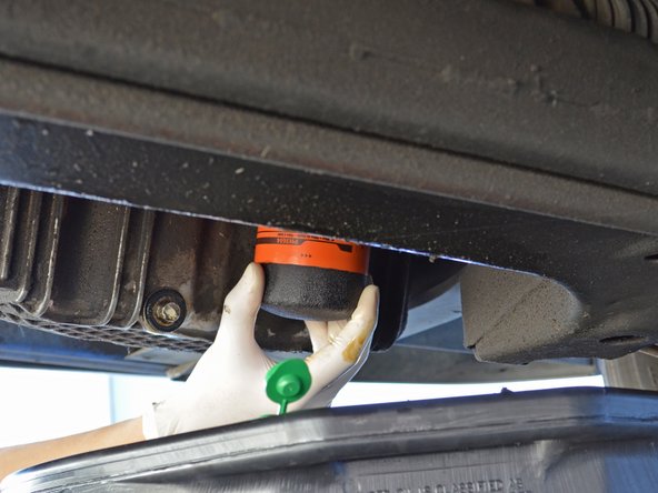

    • Wipe down the threads for the oil filter to remove any oil or debris that may have collected.
    • Keep the new oil filter facing upwards to prevent any spills and place it over the threads.
    • Tighten the filter by rotating it clockwise until it is snug. Do not over-tighten the filter.

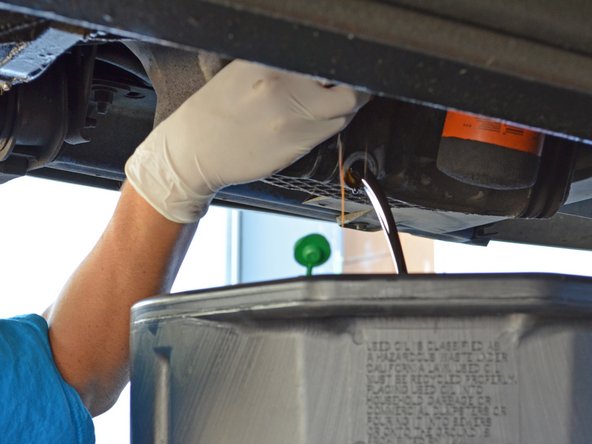

    • Remove the oil drain plug and let any oil that has collected drain out.
  10. 1995-1999 Dodge/Plymouth Neon Oil Change (SOHC): crwdns2935265:010crwdnd2935265:01crwdnd2935265:03crwdne2935265:0 1995-1999 Dodge/Plymouth Neon Oil Change (SOHC): crwdns2935265:010crwdnd2935265:02crwdnd2935265:03crwdne2935265:0 1995-1999 Dodge/Plymouth Neon Oil Change (SOHC): crwdns2935265:010crwdnd2935265:03crwdnd2935265:03crwdne2935265:0
    • Once the draining slows to a drip, use a rag or towel to wipe away any excess oil or debris from the oil drain plug hole.
    • Wipe down the oil drain plug, reinsert it, and tighten it with your fingers.

    • Finish tightening the oil drain plug with a 13 mm socket wrench.
    • Only tighten the drain plug until it is snug. Over-tightening the oil drain plug can strip or crack the oil pan—a very costly error. You can always tighten the drain plug more later.
    • Wipe off the area around the drain plug one more time with a rag or towel.

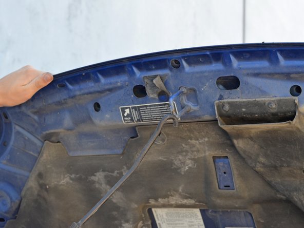

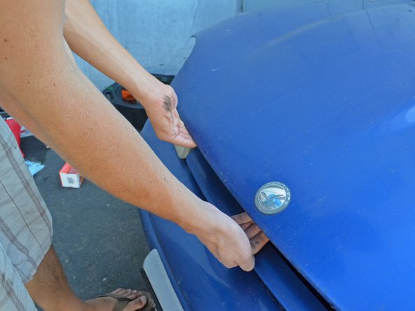

    • Open the driver's side door and pull on the hood release lever until you here a click coming from the hood.
    • Locate the release lever under the hood.
    • While pulling up on the lever with one hand, use the other to lift the hood.
  14. 1995-1999 Dodge/Plymouth Neon Oil Change (SOHC): crwdns2935265:014crwdnd2935265:01crwdnd2935265:03crwdne2935265:0 1995-1999 Dodge/Plymouth Neon Oil Change (SOHC): crwdns2935265:014crwdnd2935265:02crwdnd2935265:03crwdne2935265:0 1995-1999 Dodge/Plymouth Neon Oil Change (SOHC): crwdns2935265:014crwdnd2935265:03crwdnd2935265:03crwdne2935265:0

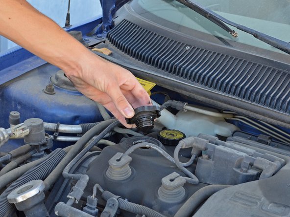

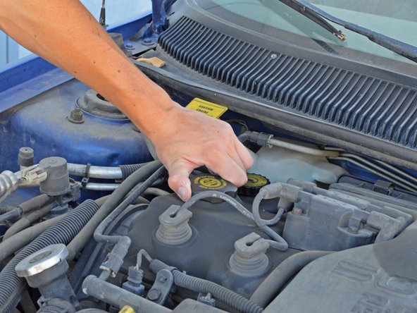

    • Prop the hood up by inserting the hood prop rod into the hole labeled "Insert Rod Here."
    • Rotate the oil filler cap one full rotation counter-clockwise and remove it.
  15. 1995-1999 Dodge/Plymouth Neon Oil Change (SOHC): crwdns2935265:015crwdnd2935265:01crwdnd2935265:03crwdne2935265:0 1995-1999 Dodge/Plymouth Neon Oil Change (SOHC): crwdns2935265:015crwdnd2935265:02crwdnd2935265:03crwdne2935265:0 1995-1999 Dodge/Plymouth Neon Oil Change (SOHC): crwdns2935265:015crwdnd2935265:03crwdnd2935265:03crwdne2935265:0

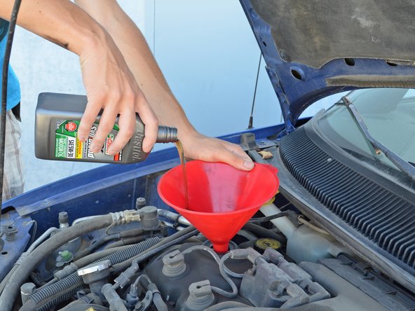

    • Wipe down the area around the filler cap with a rag or towel to remove any debris or oil.
    • Be sure to wipe outwards to avoid knocking any debris into the engine.

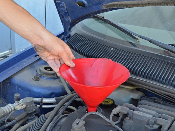

    • Place a funnel into the filler hole to avoid spilling the new oil.
    • Pour the remainder of the four quarts of 5W-30 motor oil into the filler hole.
    • Math Help: If you are using a handy-dandy 5L jug of motor oil, you should have about 1.3 quarts left over after adding four quarts..

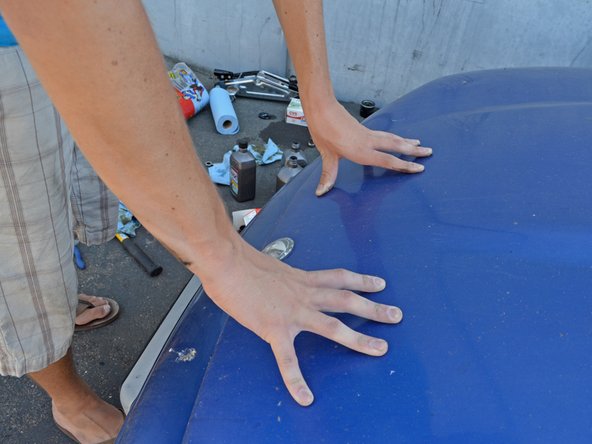

    • Place the filler cap back on and tighten it by twisting it one full rotation clockwise.
    • Remove the hood prop rod and slowly close the hood.
    • Once the hood is down, be sure to give it another firm push to make sure it is latched in place.

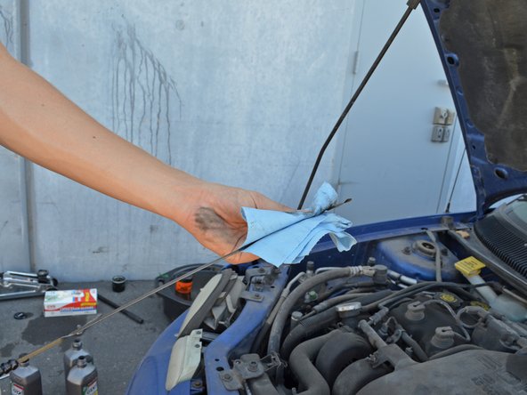

    • While it is running, re-prop open the hood and locate your yellow dipstick.
    • Be careful; the engine may be hot.

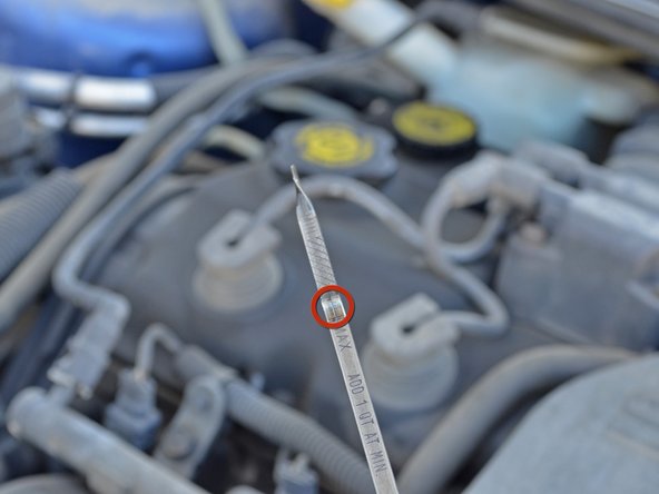

    • Remove and wipe down the yellow dipstick to assure that you get a clear oil level reading.
  18. 1995-1999 Dodge/Plymouth Neon Oil Change (SOHC): crwdns2935265:018crwdnd2935265:01crwdnd2935265:02crwdne2935265:0 1995-1999 Dodge/Plymouth Neon Oil Change (SOHC): crwdns2935265:018crwdnd2935265:02crwdnd2935265:02crwdne2935265:0
    • Insert the dipstick back into the hole. Press it all the way in, then remove it.
    • There should be a thin layer of oil up to the bump on the dipstick labeled "MAX."
    • The bump indicates the maximum amount of oil that should be in the tank while the twist at the end indicates the minimum amount. Anywhere in the cross-hatched middle area is sufficient.
    • After checking if the oil level is too high or too low, you can add or remove oil accordingly.
