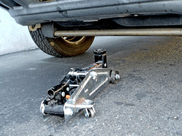

    • Begin by locating the lifting and stand points.
    • The lifting point is at the front and center of the car, just below the bumper.
    • The stand point is below the rocker panel on the driver's side of the car, just behind the front wheel
  2. 1995-2001 Honda CRV Oil Change: crwdns2935265:02crwdnd2935265:01crwdnd2935265:02crwdne2935265:0 1995-2001 Honda CRV Oil Change: crwdns2935265:02crwdnd2935265:02crwdnd2935265:02crwdne2935265:0
    • Place the jack under the lifting point and raise the front of the car until you can fit underneath it.
    • Place a jack stand under the stand point.
    • Slowly lower the jack until the jack stand is supporting the car and the jack isn't. Remove the jack.
    • Many hydraulic jacks are lowered by placing the open end of the handle over a knob and turning it counter-clockwise. Consult your owners manual for your jack if you don't know how to lower it.
    • It is helpful, but not necessary, to jack up both sides of the car. Since the oil drain plug is on the driver's side of the car, lifting just the driver's side should be sufficient.
    • Never work underneath a car that is only supported by a jack. The jack may slip or fail, resulting in serious injury or death.

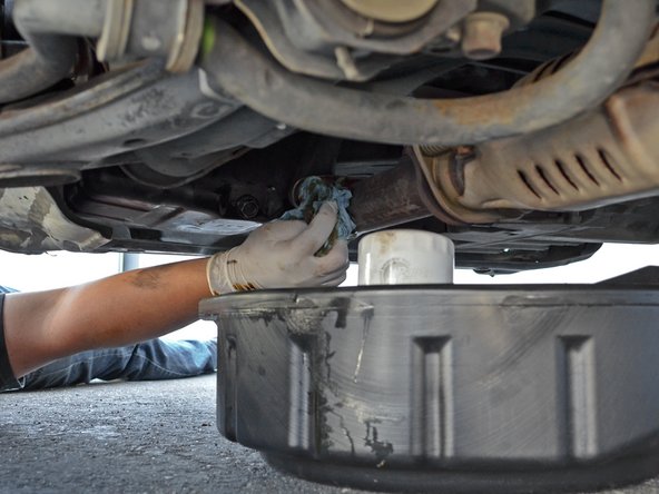

  6. 1995-2001 Honda CRV Oil Change, Replacing the Oil Filter: crwdns2935265:06crwdnd2935265:01crwdnd2935265:02crwdne2935265:0 1995-2001 Honda CRV Oil Change, Replacing the Oil Filter: crwdns2935265:06crwdnd2935265:02crwdnd2935265:02crwdne2935265:0
    • Locate the oil filter. It is on the back side of the engine, near the engine's center line and adjacent to the rear engine brace.
    • Move the oil drain pan so it will catch any oil that spills when you remove the oil filter.
  7. 1995-2001 Honda CRV Oil Change: crwdns2935265:07crwdnd2935265:01crwdnd2935265:03crwdne2935265:0 1995-2001 Honda CRV Oil Change: crwdns2935265:07crwdnd2935265:02crwdnd2935265:03crwdne2935265:0 1995-2001 Honda CRV Oil Change: crwdns2935265:07crwdnd2935265:03crwdnd2935265:03crwdne2935265:0
    • To reach the oil filter, guide your hand around the back side of the drive axle and up toward the top of the engine.
    • Be careful if the engine has been running recently. The engine and exhaust components may be very hot.
    • Twist the oil filter counter-clockwise with your hand until it comes off the threads on the engine block.
    • If the filter is too tight to loosen by hand, use an oil filter wrench. A wrench that fits over the top of the oil filter is necessary, as there is very little space on the sides of the oil filter.
    • Lower the oil filter out of the engine bay with the threads facing up, then place it in the oil drain pan with the threads facing down.
    • Wipe off as much spilled oil as possible.

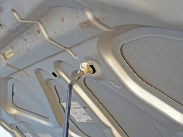

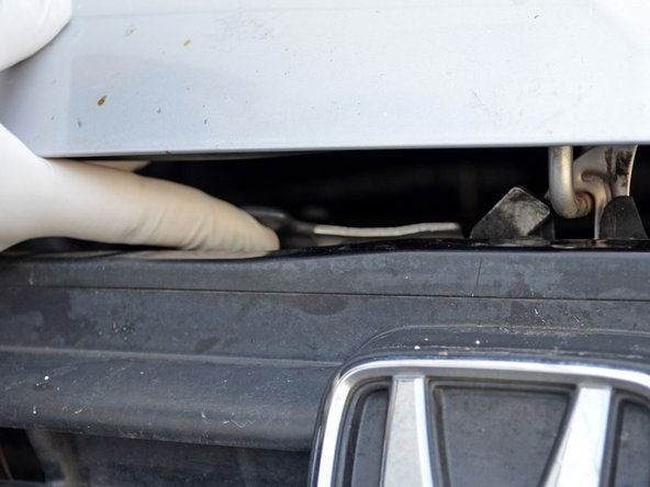

    • Locate the hood release lever. It is below the left side of the driver console, just under the trunk release lever.
    • Pull the lever until you hear the hood click.
    • Go to the front of the car and locate the hood release latch. It is under the hood and slightly towards the passenger side of the car.
    • Lift up on the hood release latch and lift the hood open.
    • Place the end of the hood prop rod into the hole on the driver side of the hood marked by an arrow.

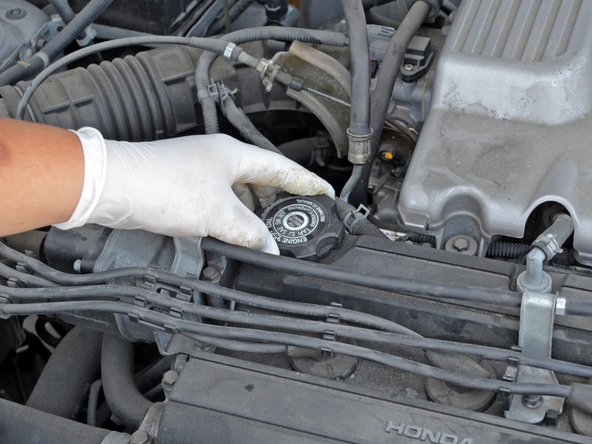

    • Locate the oil filler cap. It is on the passenger side of the valve cover, towards the rear.
    • Twist the oil filler cap counter-clockwise and remove it.
