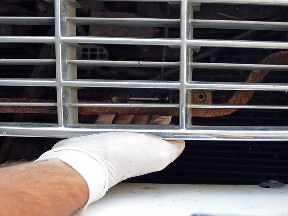

    • Locate the hood release lever near the driver side footwell and pull it until you hear the hood click open.
    • Lift the hood release latch near the center of the front grill and raise the hood.
