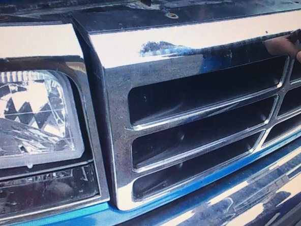

    • Remove the 5 screws with the screwdriver to remove the grill.
  2. 1992-1996 Ford F series-Bronco Header Panel Replacement: crwdns2935265:02crwdnd2935265:01crwdnd2935265:01crwdne2935265:0

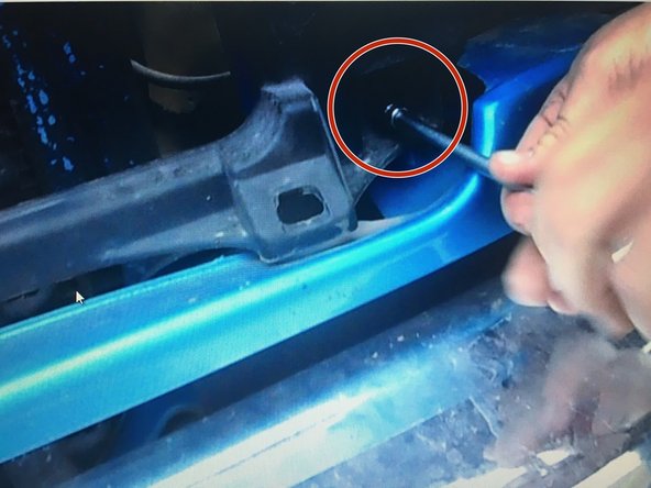

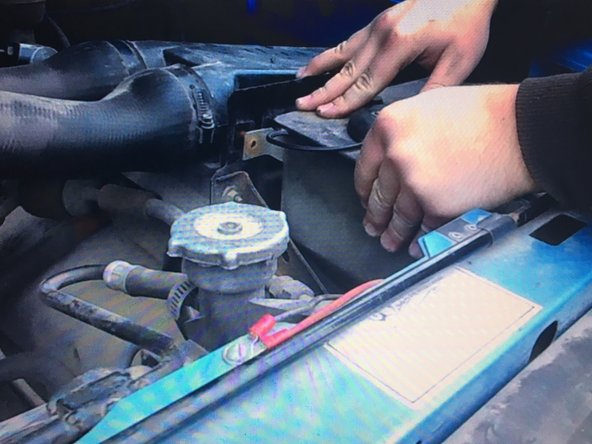

    • Set aside the windshield fluid/coolant reservoir by removing the 11mm bolt.
  3. 1992-1996 Ford F series-Bronco Header Panel Replacement: crwdns2935265:03crwdnd2935265:01crwdnd2935265:01crwdne2935265:0

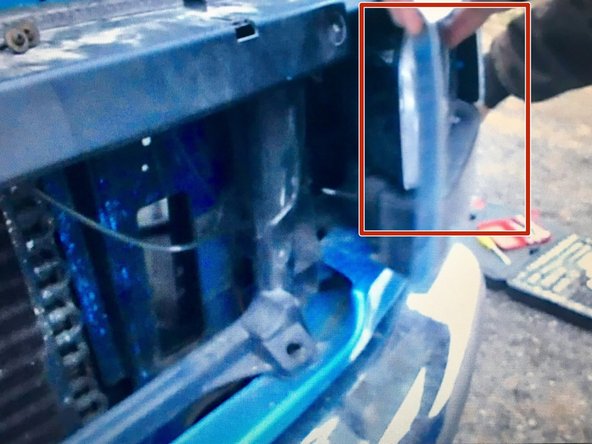

    • Remove the two screws on top of the headlight bezel, and the two 11mm bolts on the back of the bezel.
    • Then, remove the bolts from the housing. Repeat this step for the other headlight.

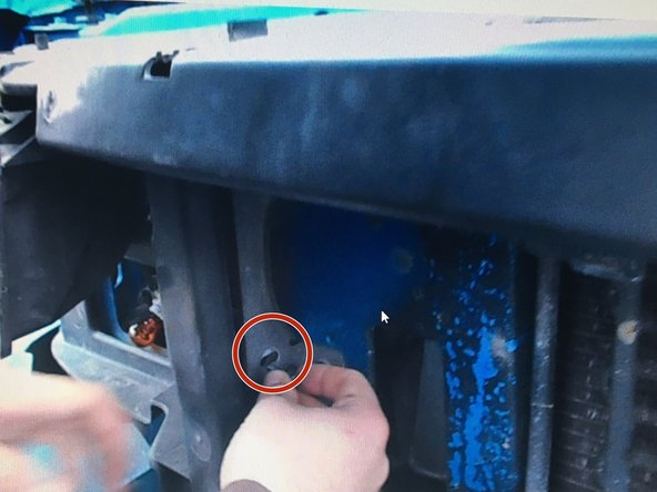

  4. 1992-1996 Ford F series-Bronco Header Panel Replacement: crwdns2935265:04crwdnd2935265:01crwdnd2935265:01crwdne2935265:0
    • Remove the bolts retaining the header panel using the 8mm socket and ratchet.

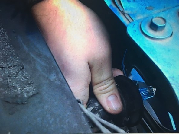

  5. 1992-1996 Ford F series-Bronco Header Panel Replacement: crwdns2935265:05crwdnd2935265:01crwdnd2935265:01crwdne2935265:0
    • Remove the headlight bulbs from the headlight housing by turning them counterclockwise on the retaining clip.

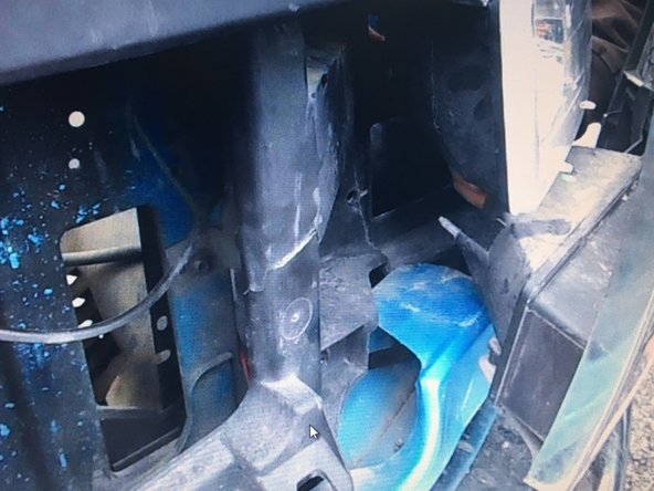

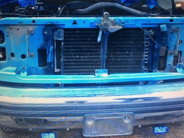

  6. 1992-1996 Ford F series-Bronco Header Panel Replacement: crwdns2935265:06crwdnd2935265:01crwdnd2935265:01crwdne2935265:0
    • Remove the old header panel, and install the replacement panel.
  7. 1992-1996 Ford F series-Bronco Header Panel Replacement: crwdns2935265:07crwdnd2935265:01crwdnd2935265:01crwdne2935265:0
    • Replace all of the bolts that retain the header panel.

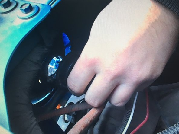

  8. 1992-1996 Ford F series-Bronco Header Panel Replacement: crwdns2935265:08crwdnd2935265:01crwdnd2935265:01crwdne2935265:0
    • Reinstall the headlight bulbs by turning clockwise on the retaining clip.

  10. 1992-1996 Ford F series-Bronco Header Panel Replacement: crwdns2935265:010crwdnd2935265:01crwdnd2935265:01crwdne2935265:0
    • Reinstall the windshield fluid/coolant reservoir with the 11mm bolt.
  11. 1992-1996 Ford F series-Bronco Header Panel Replacement: crwdns2935265:011crwdnd2935265:01crwdnd2935265:01crwdne2935265:0
    • Reinstall the grill with the 5 screws.
