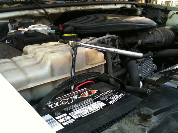

  8. 1991-1996 Chevrolet Caprice Battery Replacement: crwdns2935265:08crwdnd2935265:01crwdnd2935265:02crwdne2935265:0 1991-1996 Chevrolet Caprice Battery Replacement: crwdns2935265:08crwdnd2935265:02crwdnd2935265:02crwdne2935265:0
    • With your 13mm socket, remove the bolt that holds the block, that holds the battery in. This bolt will not come out completely. Once you feel slack in the bolt you may remove the whole block.
    • Make sure you do not touch the positive and negative terminals, you might get shocked!
