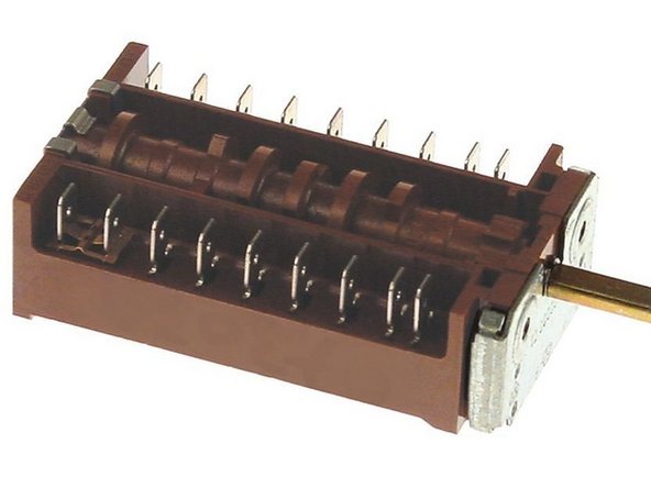

    • The oven switch (with 10 settings and 10 contacts) is defective, and the original replacement part after 30 years is no longer available.
  2. 1990's Stove Philips Whirlpool oven switch replacement, Replacement found: crwdns2935265:03crwdnd2935265:01crwdnd2935265:01crwdne2935265:0
    • I found oven switches with 10 settings and 7 contacts online. They look completely different, but they do the same thing.
    • Good news: the two screws for attaching them fit, and the axle is the right length.

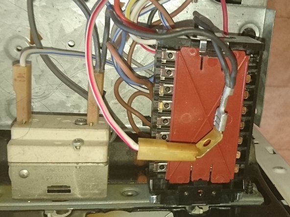

  3. 1990's Stove Philips Whirlpool oven switch replacement, Which connector goes where?: crwdns2935265:04crwdnd2935265:01crwdnd2935265:01crwdne2935265:0
    • I measured the new and old switch and came up with the following assignment:
    • Switch Input:
    • 1, 2, 3, 4, 5, 6 = brown = mains phase
    • 7 = blue = mains neutral
    • Switch Output:
    • 1 = brown = light || 2 = gray = motor || 3 = white = hot air
    • 4 = red/white = top heat || 5 = yellow/white = bottom heat
    • 6 = red = grill || 7 = blue/white = ‘return’
    • There is no separate output for the red temperature indicator light; this would require an 8-pin switch. However, it also works without this: simply connect the indicator light (brown) to 1 = light.
  4. 1990's Stove Philips Whirlpool oven switch replacement, connect the second red/white wire: crwdns2935265:06crwdnd2935265:01crwdnd2935265:01crwdne2935265:0
    • The second red/white (top heat ‘return’) is connected to black (thermostat).
    • Insulate with electrical tape!
    • Done! - For those who want to know exactly:
    • The original switch was able to switch the top heat and grill in series, i.e., it could establish a connection between red/white-2 and red.... No idea what that's good for.... The new replacement switch can't do that.... But no problem, it works this way too....
