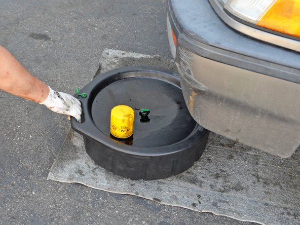

  2. 1988-1991 Honda Civic Oil Change, Draining the Oil: crwdns2935265:02crwdnd2935265:01crwdnd2935265:03crwdne2935265:0 1988-1991 Honda Civic Oil Change, Draining the Oil: crwdns2935265:02crwdnd2935265:02crwdnd2935265:03crwdne2935265:0 1988-1991 Honda Civic Oil Change, Draining the Oil: crwdns2935265:02crwdnd2935265:03crwdnd2935265:03crwdne2935265:0
    • Always wear protective gloves and eyewear when working with motor oil. Be careful if your car has been running recently as the engine, transmission and exhaust may be very hot. Keep rags or towels nearby to wipe up any spills.
    • Locate the 17mm hex oil drain plug. It is on the driver's side of the car and facing backwards.
    • Use a 17 mm socket wrench or box end wrench to turn the oil drain plug counter-clockwise until it is loose enough to turn by hand.
    • Place the oil drain pan underneath the oil drain plug.
    • Be sure that the drain pan is positioned so that it will catch the oil when it is streaming out of the pan.

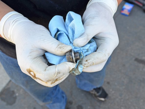

  3. 1988-1991 Honda Civic Oil Change: crwdns2935265:03crwdnd2935265:01crwdnd2935265:03crwdne2935265:0 1988-1991 Honda Civic Oil Change: crwdns2935265:03crwdnd2935265:02crwdnd2935265:03crwdne2935265:0 1988-1991 Honda Civic Oil Change: crwdns2935265:03crwdnd2935265:03crwdnd2935265:03crwdne2935265:0
    • Finish removing the oil drain plug by hand and allow the oil to drain.
    • Watch the draining oil for shiny specks. These shiny specks may be metal flakes and could mean that there is a serious problem with your engine internals.
    • Clean the oil drain plug with a clean rag or towel. If the oil drain plug gasket is damaged, replace it.

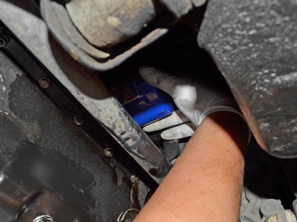

  5. 1988-1991 Honda Civic Oil Change, Replacing the Oil Filter: crwdns2935265:05crwdnd2935265:01crwdnd2935265:03crwdne2935265:0 1988-1991 Honda Civic Oil Change, Replacing the Oil Filter: crwdns2935265:05crwdnd2935265:02crwdnd2935265:03crwdne2935265:0 1988-1991 Honda Civic Oil Change, Replacing the Oil Filter: crwdns2935265:05crwdnd2935265:03crwdnd2935265:03crwdne2935265:0
    • Locate the oil filter. It is on the driver's side of the car, on the back side of the engine and above the oil drain plug.
    • Reposition the oil drain pan so that it catches the oil that will spill when you remove the oil filter.
    • Turn the oil filter counter-clockwise by hand until it comes off the engine's oil filter threads.
    • If the filter is too tight to loosen by hand, use an oil filter wrench. A wrench that fits over the top of the oil filter is ideal, as there is very little space on the sides of the oil filter.
    • Lower the oil filter with its threaded end up to reduce spills, then place it with the threaded end facing down in the oil drain pan.

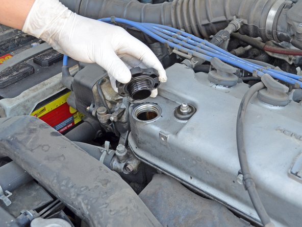

  9. 1988-1991 Honda Civic Oil Change: crwdns2935265:09crwdnd2935265:01crwdnd2935265:03crwdne2935265:0 1988-1991 Honda Civic Oil Change: crwdns2935265:09crwdnd2935265:02crwdnd2935265:03crwdne2935265:0 1988-1991 Honda Civic Oil Change: crwdns2935265:09crwdnd2935265:03crwdnd2935265:03crwdne2935265:0
    • Locate the oil filler cap. It is on the front passenger side of the valve cover.
    • Turn the oil filler cap counter-clockwise and remove it.
    • Place a funnel into the oil filler hole.

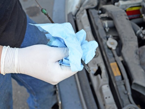

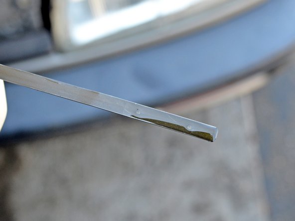

  11. 1988-1991 Honda Civic Oil Change: crwdns2935265:011crwdnd2935265:01crwdnd2935265:03crwdne2935265:0 1988-1991 Honda Civic Oil Change: crwdns2935265:011crwdnd2935265:02crwdnd2935265:03crwdne2935265:0 1988-1991 Honda Civic Oil Change: crwdns2935265:011crwdnd2935265:03crwdnd2935265:03crwdne2935265:0
    • Locate and remove the oil dipstick. It is in front of the valve cover, sticking out of the exhaust manifold's heat shield.
    • Wipe off the oil dipstick, reinsert it into its hole and remove it again.
    • Check the oil level on the end of the dipstick. It should be between the two holes or slightly above the top one.
    • This is not your actual oil level, but a pre-check to make sure the engine will not run dry when you first start it. The oil level will drop slightly after the first run when oil fills the new oil filter.
    • Add oil if the oil level is below the bottom hole of the dipstick. Place the oil dipstick all the way back in its hole.
