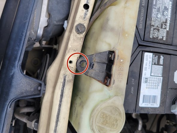

  3. 1986 Toyota Pickup Windshield Washer Pump Replacement: crwdns2935265:03crwdnd2935265:01crwdnd2935265:02crwdne2935265:0 1986 Toyota Pickup Windshield Washer Pump Replacement: crwdns2935265:03crwdnd2935265:02crwdnd2935265:02crwdne2935265:0
    • Using a ratchet and a 10 mm socket, remove the 10 mm bolt that holds the washer bottle in place.

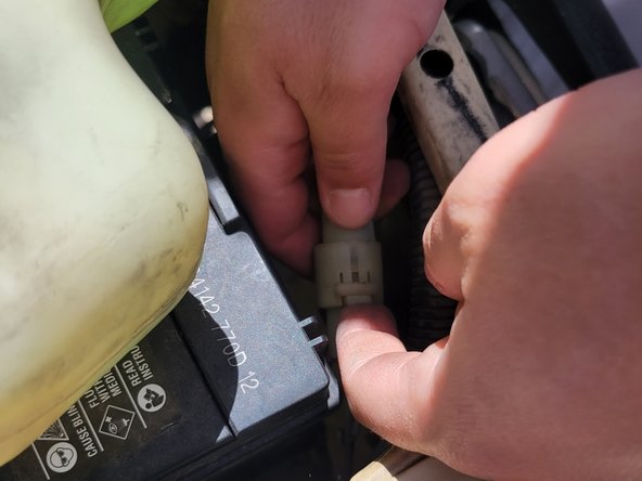

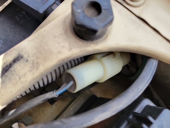

  4. 1986 Toyota Pickup Windshield Washer Pump Replacement: crwdns2935265:04crwdnd2935265:01crwdnd2935265:03crwdne2935265:0 1986 Toyota Pickup Windshield Washer Pump Replacement: crwdns2935265:04crwdnd2935265:02crwdnd2935265:03crwdne2935265:0 1986 Toyota Pickup Windshield Washer Pump Replacement: crwdns2935265:04crwdnd2935265:03crwdnd2935265:03crwdne2935265:0
    • Disconnect the pump electrical connector.
    • You may have to partially or fully remove the washer bottle to access the connector.
    • You can also remove or slide the battery over in its spot to have more space to access the connector.
    • To unplug the connector, push up on the tab of the female connector and pull the two apart. Be patient, as the plastic can be very brittle.

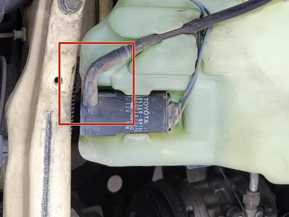

  5. 1986 Toyota Pickup Windshield Washer Pump Replacement: crwdns2935265:05crwdnd2935265:01crwdnd2935265:02crwdne2935265:0 1986 Toyota Pickup Windshield Washer Pump Replacement: crwdns2935265:05crwdnd2935265:02crwdnd2935265:02crwdne2935265:0
    • Lift the washer bottle out of place. Be mindful of the hose that connects the pump to the sprayers.
    • Disconnect the hose from the pump using the needle nose pliers (optional).
    • Remove the hose from its slot in the washer bottle and empty the washer fluid into a temporary container.
    • This is also optional, but will save you from having to balance the bottle to keep it from spilling.

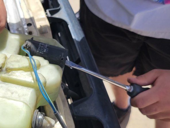

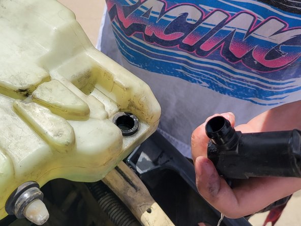

  6. 1986 Toyota Pickup Windshield Washer Pump Replacement: crwdns2935265:06crwdnd2935265:01crwdnd2935265:03crwdne2935265:0 1986 Toyota Pickup Windshield Washer Pump Replacement: crwdns2935265:06crwdnd2935265:02crwdnd2935265:03crwdne2935265:0 1986 Toyota Pickup Windshield Washer Pump Replacement: crwdns2935265:06crwdnd2935265:03crwdnd2935265:03crwdne2935265:0
    • Carefully pry the pump out of the washer bottle with the flathead screwdriver.
    • If your new washer pump did not come with an O-ring, be mindful to not damage the old one.
    • If you have a new O-ring, remove and replace the O-ring as well.
