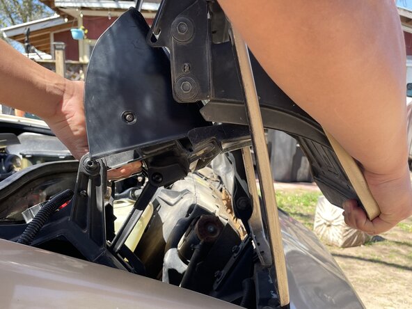

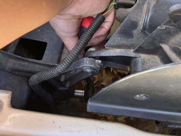

    • Open and prop the hood.
    • Disconnect the battery.

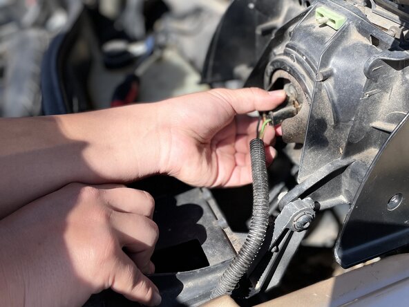

    • Disconnect the headlight from its housing by removing the four bolts with a 10mm socket and wrench.
    • Use the socket to hold one end of each bolt in place while using the wrench to loosen.
    • There are two bolts on the top and two bolts on the bottom.

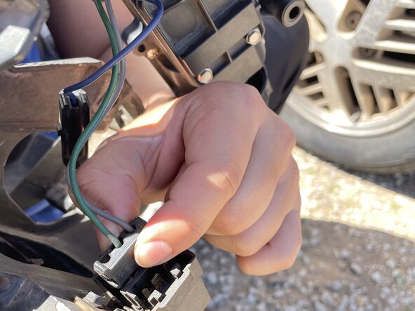

    • Disconnect the headlight power cable that leads to the lightbulb, then remove the headlight from its housing to continue to disconnect the remaining wires.

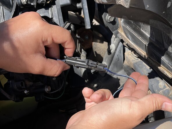

  2. 1986 Pontiac Fiero Headlight Motor Gear Replacement: crwdns2935265:02crwdnd2935265:01crwdnd2935265:03crwdne2935265:0 1986 Pontiac Fiero Headlight Motor Gear Replacement: crwdns2935265:02crwdnd2935265:02crwdnd2935265:03crwdne2935265:0 1986 Pontiac Fiero Headlight Motor Gear Replacement: crwdns2935265:02crwdnd2935265:03crwdnd2935265:03crwdne2935265:0
    • Disconnect the blue wire that leads to the motor, and the red wire harness that leads to the headlight relay.
    • Move the headlight to a clean working space.

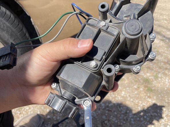

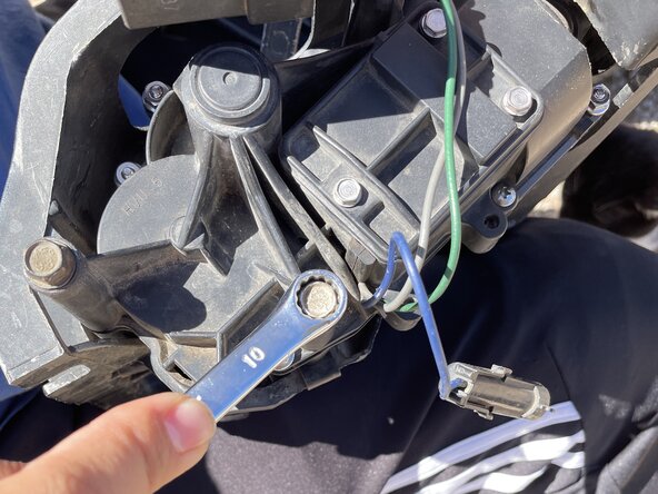

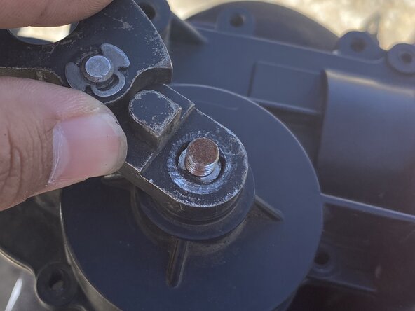

    • Remove the motor from the headlight and remove the three screws around the motor securing it to the headlight casing, and the screws on the motor arm.
    • Use the 10mm for the screws on the casing and for the nut on the arm.
    • In this step you will use the 1/4 Allen wrench to hold the arm screw in place.

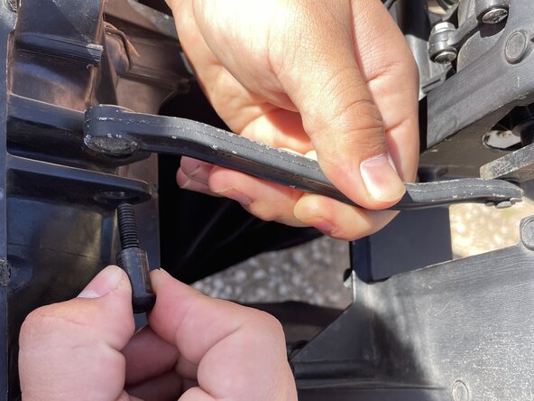

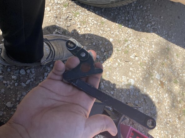

    • Remove the arm with gentle but firm pressure, if the arm will not budge, hit it with a mallet/hammer to slide it off the rod.

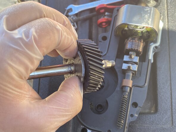

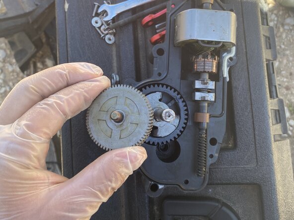

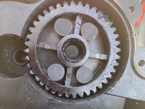

  8. 1986 Pontiac Fiero Headlight Motor Gear Replacement: crwdns2935265:09crwdnd2935265:01crwdnd2935265:03crwdne2935265:0 1986 Pontiac Fiero Headlight Motor Gear Replacement: crwdns2935265:09crwdnd2935265:02crwdnd2935265:03crwdne2935265:0 1986 Pontiac Fiero Headlight Motor Gear Replacement: crwdns2935265:09crwdnd2935265:03crwdnd2935265:03crwdne2935265:0

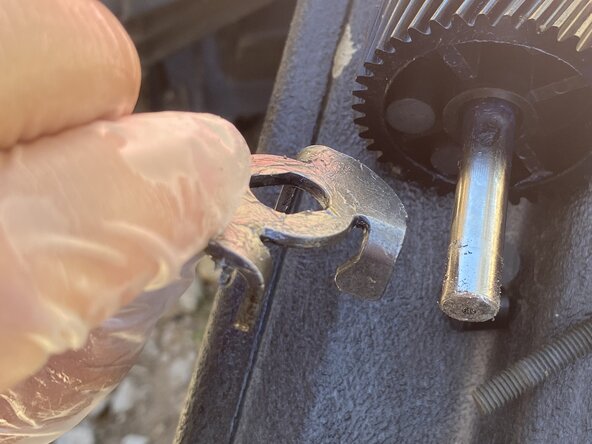

    • When removing the cover you should see two gears, on meatal, one plastic, and a metal lever in between.
    • Remove both gears and the lever remembering their orientation or taking a picture.

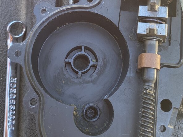

  9. 1986 Pontiac Fiero Headlight Motor Gear Replacement: crwdns2935265:010crwdnd2935265:01crwdnd2935265:03crwdne2935265:0 1986 Pontiac Fiero Headlight Motor Gear Replacement: crwdns2935265:010crwdnd2935265:02crwdnd2935265:03crwdne2935265:0 1986 Pontiac Fiero Headlight Motor Gear Replacement: crwdns2935265:010crwdnd2935265:03crwdnd2935265:03crwdne2935265:0
    • Clean out the plastic gear casing as it will most likely be covered in plastic shavings and dried grease.
    • Clean the lever as it may also have what is left of a rubber spacer coating it and the residue will cause problems if left unchecked.

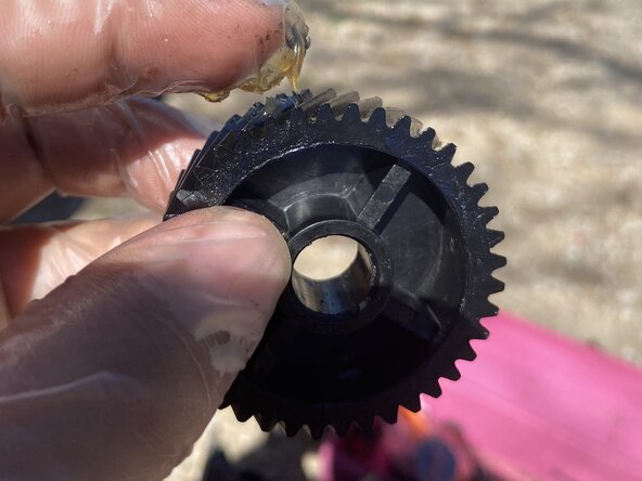

  10. 1986 Pontiac Fiero Headlight Motor Gear Replacement: crwdns2935265:011crwdnd2935265:01crwdnd2935265:02crwdne2935265:0 1986 Pontiac Fiero Headlight Motor Gear Replacement: crwdns2935265:011crwdnd2935265:02crwdnd2935265:02crwdne2935265:0
    • Put new grease on a new plastic gear, then replace the old plastic gear in the motor.
  11. 1986 Pontiac Fiero Headlight Motor Gear Replacement: crwdns2935265:012crwdnd2935265:01crwdnd2935265:02crwdne2935265:0 1986 Pontiac Fiero Headlight Motor Gear Replacement: crwdns2935265:012crwdnd2935265:02crwdnd2935265:02crwdne2935265:0
    • Put new rubber spacers in the far corners of the inside of the plastic gear.
  12. 1986 Pontiac Fiero Headlight Motor Gear Replacement: crwdns2935265:013crwdnd2935265:01crwdnd2935265:01crwdne2935265:0
    • Put in a lever and make sure it fits snugly and once you do put the metal gear on.
