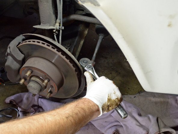

    • Use a socket wrench or impact gun to remove the 15 mm nut on the front sway bar endlink.

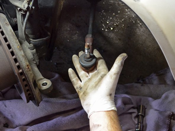

    • Use a socket wrench or impact gun to remove the 19 mm tie rod end nut.
  5. 1986-1993 Volvo 240 Front Struts Replacement: crwdns2935265:05crwdnd2935265:01crwdnd2935265:02crwdne2935265:0 1986-1993 Volvo 240 Front Struts Replacement: crwdns2935265:05crwdnd2935265:02crwdnd2935265:02crwdne2935265:0
    • Place a tie rod end puller over the exposed threads of the tie rod end and turn the puller with a socket wrench to push the tie rod end out of the steering knuckle.

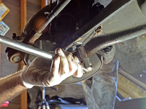

    • The ball joint is held to the control arm by three 18 mm bolts.
    • Remove the bottom two nuts with a breaker bar or long wrench.
    • Place a breaker bar over the gold nut on the bottom of the control arm.
    • The breaker bar alone will not be able to loosen the nut, since the bolt is free to rotate.
    • Place an 18 mm box end wrench over the bolt on top of the control arm.
    • Turn the breaker bar and the wrench in their respective counterclockwise directions to loosen and remove the third ball joint-to-control arm bolt.

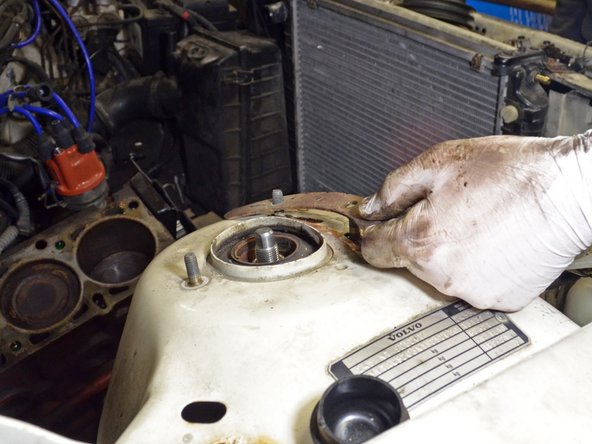

    • Open the hood and locate the three strut mounting bolts on the strut tower.
    • Make an alignment mark on the shoe at the dimple in the top of the strut tower before removing the mounting nuts.
    • Use a ratcheting socket wrench or impact wrench with a 13 mm deep socket to remove the three nuts.

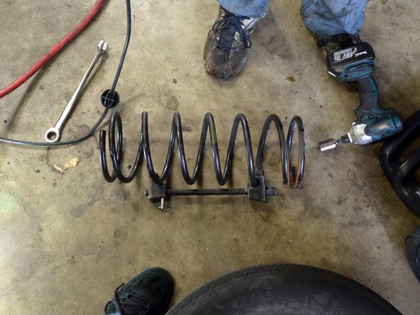

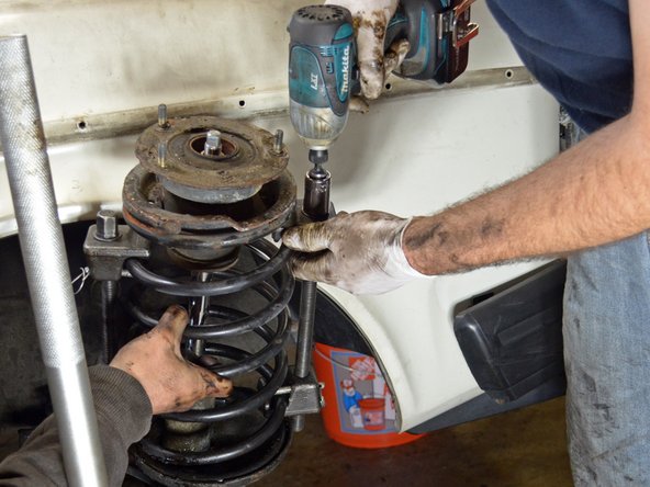

    • Place spring compressors on opposite sides of the spring.
    • Make sure you are using spring compressors that are meant for MacPherson struts. Internal-type spring compressors will not work.
    • Alternate tightening the spring compressors evenly until you are able to move the entire spring up and down.

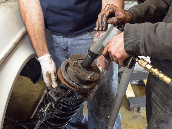

  11. 1986-1993 Volvo 240 Front Struts Replacement: crwdns2935265:011crwdnd2935265:01crwdnd2935265:03crwdne2935265:0 1986-1993 Volvo 240 Front Struts Replacement: crwdns2935265:011crwdnd2935265:02crwdnd2935265:03crwdne2935265:0 1986-1993 Volvo 240 Front Struts Replacement: crwdns2935265:011crwdnd2935265:03crwdnd2935265:03crwdne2935265:0
    • Use an impact wrench to remove the 24 mm nut at the top of the strut assembly.
    • Remove the strut mount from the strut assembly.
  12. 1986-1993 Volvo 240 Front Struts Replacement: crwdns2935265:012crwdnd2935265:01crwdnd2935265:02crwdne2935265:0 1986-1993 Volvo 240 Front Struts Replacement: crwdns2935265:012crwdnd2935265:02crwdnd2935265:02crwdne2935265:0
    • Remove the upper spring seat and pull the spring off the strut assembly.
    • If you are installing new springs you will need to remove the spring compressors. Loosen each spring compressor evenly, alternating from side to side until they are off the spring completely.
    • When installing new springs you will need to compress them with the spring compressors before placing them on the strut assembly.
    • If you are reinstalling the same springs you may keep the compressors in place until it is time to reassemble the suspension.
