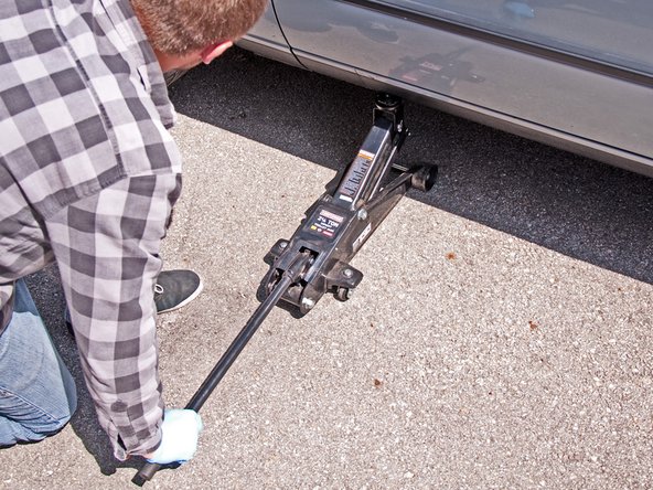

  3. 1984-1991 BMW 3 Series Oil Change (Straight 6 Models): crwdns2935265:03crwdnd2935265:01crwdnd2935265:03crwdne2935265:0 1984-1991 BMW 3 Series Oil Change (Straight 6 Models): crwdns2935265:03crwdnd2935265:02crwdnd2935265:03crwdne2935265:0 1984-1991 BMW 3 Series Oil Change (Straight 6 Models): crwdns2935265:03crwdnd2935265:03crwdnd2935265:03crwdne2935265:0

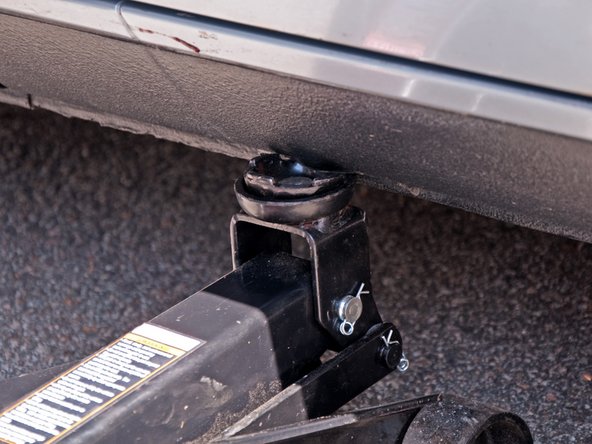

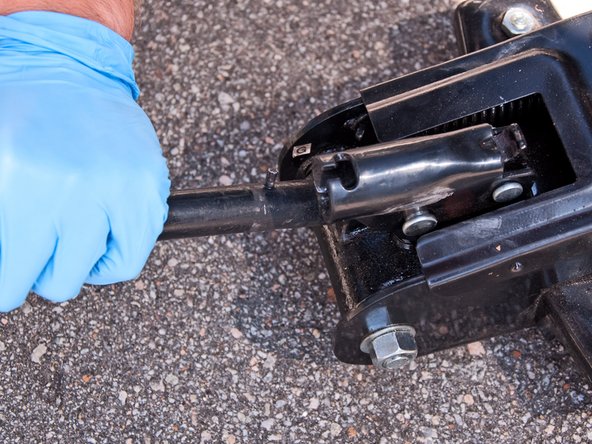

    • For oil changes, I normally just jack up the front driver's side corner of the car. It provides plenty of clearance for an oil drain pan.
    • Locate the factory jack point. On E30s, it is just behind the front quarter panel along the bottom edge of the rocker panel.
    • Use a hydraulic jack (or your factory jack) to lift the driver's side of the car.
    • Be sure that the jack pad stays firmly planted in the jack point as you lift the car. The pad on my jack has a nice little tab that fits up into the hole in the middle of the jack point to help keep it secure.

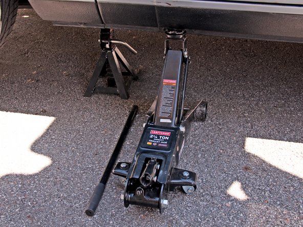

  4. 1984-1991 BMW 3 Series Oil Change (Straight 6 Models): crwdns2935265:04crwdnd2935265:01crwdnd2935265:03crwdne2935265:0 1984-1991 BMW 3 Series Oil Change (Straight 6 Models): crwdns2935265:04crwdnd2935265:02crwdnd2935265:03crwdne2935265:0 1984-1991 BMW 3 Series Oil Change (Straight 6 Models): crwdns2935265:04crwdnd2935265:03crwdnd2935265:03crwdne2935265:0

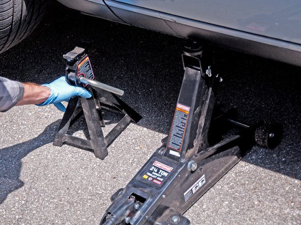

    • Lift the car enough to place a jack stand underneath a flat portion of the frame rail just behind the control arm bushing.
    • Gently allow the car to fall onto the jackstand, lifting the car and re-adjusting its position as necessary.
    • Once all of the weight has been transferred to the jack stand, tighten the release plug on the jack and leave it positioned under the jack point as seen in the third picture.
    • To be safe, jack stands should never be the only thing holding your car up. Always leave the jack up against the jack point in case the jack stand fails.

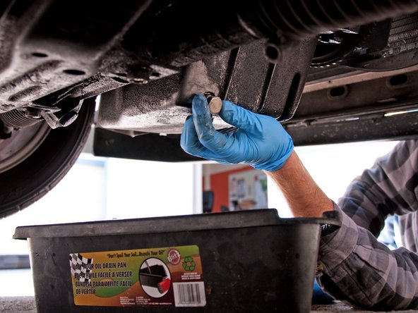

  5. 1984-1991 BMW 3 Series Oil Change (Straight 6 Models), Draining the Old Oil: crwdns2935265:05crwdnd2935265:01crwdnd2935265:01crwdne2935265:0

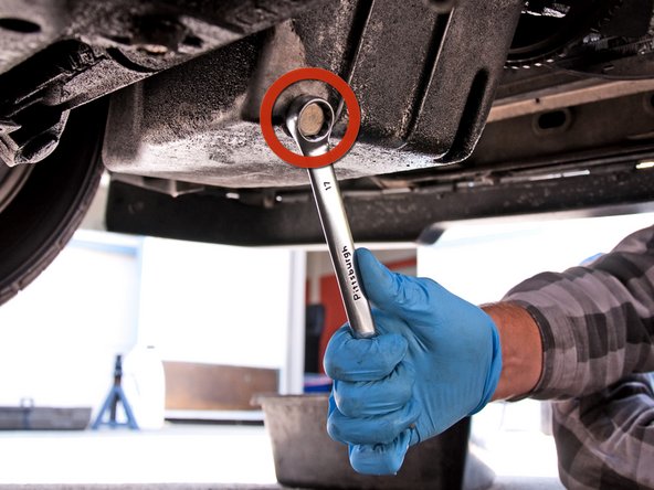

    • Locate the oil pan drain plug. It will be located on the passenger side of the oil pan nearest the center of the car.
  6. 1984-1991 BMW 3 Series Oil Change (Straight 6 Models): crwdns2935265:06crwdnd2935265:01crwdnd2935265:03crwdne2935265:0 1984-1991 BMW 3 Series Oil Change (Straight 6 Models): crwdns2935265:06crwdnd2935265:02crwdnd2935265:03crwdne2935265:0 1984-1991 BMW 3 Series Oil Change (Straight 6 Models): crwdns2935265:06crwdnd2935265:03crwdnd2935265:03crwdne2935265:0
    • Use a 17 mm wrench to loosen the oil drain plug.
    • Before removing the plug, be sure to place a drain pan underneath the oil pan to catch the oil.
    • Remove the drain plug, being sure that your drain pan will catch the oil even as its flow rate from the pan drops.
    • Allow the oil to drain until it stops to a slow drip. To save time, i normally proceed to change the oil filter while the oil is still draining.

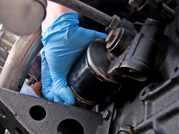

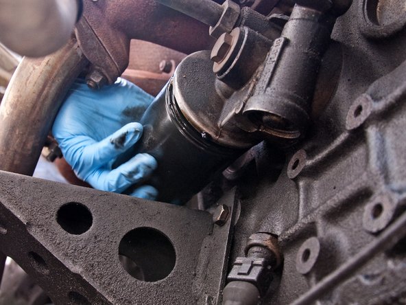

  7. 1984-1991 BMW 3 Series Oil Change (Straight 6 Models), Changing the Oil Filter: crwdns2935265:07crwdnd2935265:01crwdnd2935265:01crwdne2935265:0
    • Locate the oil filter. It will be located beneath the exhaust manifolds.
    • Before proceeding, be sure your exhaust manifolds are cool to the touch to avoid burning your hands and arms.
  8. 1984-1991 BMW 3 Series Oil Change (Straight 6 Models): crwdns2935265:08crwdnd2935265:01crwdnd2935265:03crwdne2935265:0 1984-1991 BMW 3 Series Oil Change (Straight 6 Models): crwdns2935265:08crwdnd2935265:02crwdnd2935265:03crwdne2935265:0 1984-1991 BMW 3 Series Oil Change (Straight 6 Models): crwdns2935265:08crwdnd2935265:03crwdnd2935265:03crwdne2935265:0

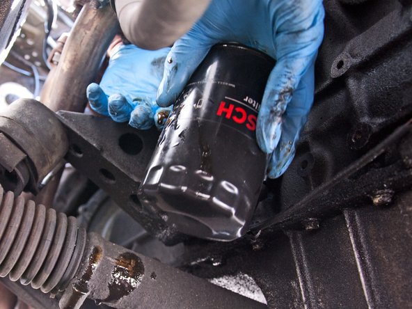

    • Be sure your drain pan is positioned beneath the oil filter housing. As you remove the oil filter, a bit of oil will drain from both the filter and the point where it seats against the housing.
    • Unscrew the oil filter and allow the oil to drain adequately before proceeding.
    • If your oil filter is stuck, you may need an oil filter strap wrench to remove it. They can be found at most auto parts stores. In a bind, you can also hammer a flathead screwdriver through the body of the filter to gain leverage (this process is messy).
  9. 1984-1991 BMW 3 Series Oil Change (Straight 6 Models): crwdns2935265:09crwdnd2935265:01crwdnd2935265:02crwdne2935265:0 1984-1991 BMW 3 Series Oil Change (Straight 6 Models): crwdns2935265:09crwdnd2935265:02crwdnd2935265:02crwdne2935265:0
    • Maneuver the oil filter away from your engine and out of the car, trying your best not to spill oil everywhere.
    • This process is a bit easier on my car because I've removed my A/C compressor (long story). For those of you with the A/C compressor still installed, you may have to get a little creative to remove the filter without getting oil all over everything.

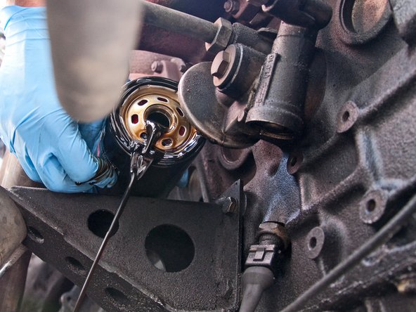

  11. 1984-1991 BMW 3 Series Oil Change (Straight 6 Models), Installing the New Oil Filter: crwdns2935265:011crwdnd2935265:01crwdnd2935265:01crwdne2935265:0
    • Dip your finger into a bit of the oil you just drained from the engine and spread it on the large O-ring around the open end of your new oil filter.
    • Lubricating the O-ring will help to ensure a good seal.

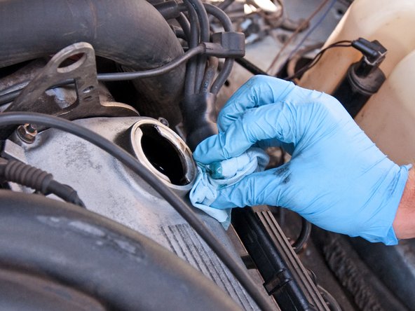

  15. 1984-1991 BMW 3 Series Oil Change (Straight 6 Models), Adding New Oil: crwdns2935265:015crwdnd2935265:01crwdnd2935265:01crwdne2935265:0

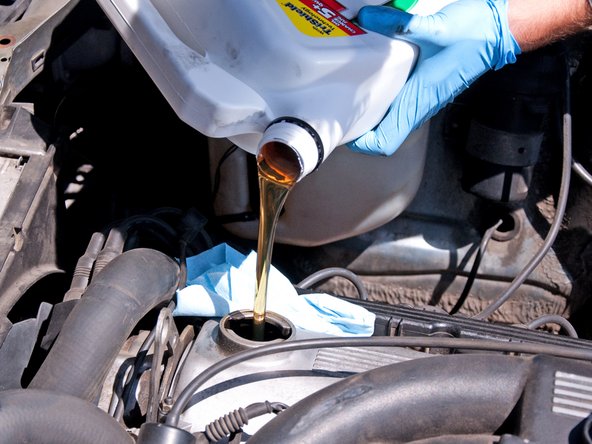

    • Twist the oil filler cap 1/4 turn counter-clockwise and remove it from the valve cover.
  16. 1984-1991 BMW 3 Series Oil Change (Straight 6 Models): crwdns2935265:016crwdnd2935265:01crwdnd2935265:03crwdne2935265:0 1984-1991 BMW 3 Series Oil Change (Straight 6 Models): crwdns2935265:016crwdnd2935265:02crwdnd2935265:03crwdne2935265:0 1984-1991 BMW 3 Series Oil Change (Straight 6 Models): crwdns2935265:016crwdnd2935265:03crwdnd2935265:03crwdne2935265:0
    • You may want to use a funnel to help avoid spills on this step.
    • Pack a clean paper towel below the oil filler hole on the valve cover to catch any oil that might spill.
    • Fill the engine up with 4.5 Quarts of oil. The M20 engine uses 20W-50 conventional oil.
    • After you've filled the oil, wipe up any spills with your towel.
    • Reinstall the oil filler cap.

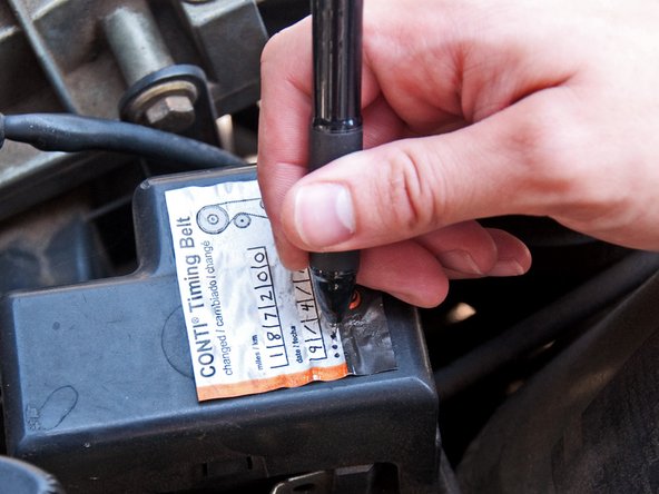

    • To keep track of my oil change intervals, I usually make a little dot on my timing belt sticker every time I change the oil. Each dot corresponds to 3,000 miles.
