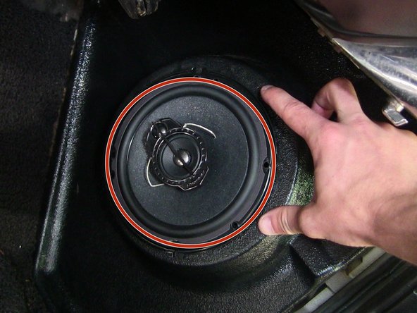

  2. 1967-68 Mustang Kick Panel Speaker Replacement: crwdns2935265:02crwdnd2935265:01crwdnd2935265:01crwdne2935265:0
    • Locate the kick panel speaker that needs to be replaced.

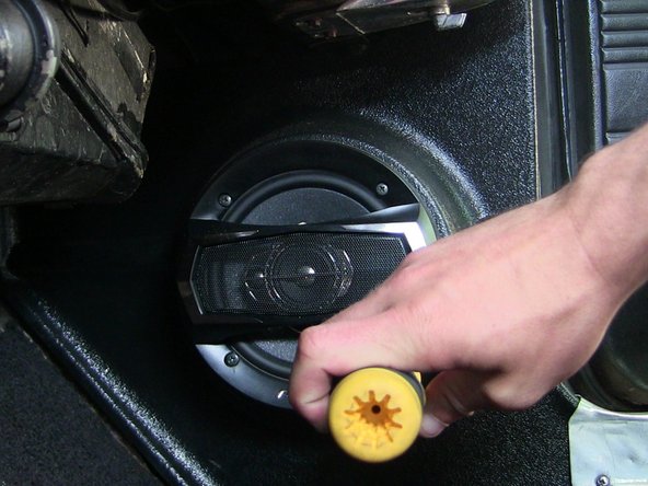

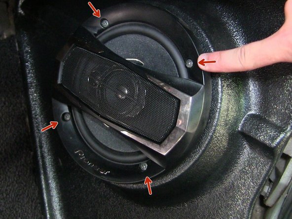

  3. 1967-68 Mustang Kick Panel Speaker Replacement: crwdns2935265:03crwdnd2935265:01crwdnd2935265:01crwdne2935265:0
    • Locate the two top screws as well as the two bottom screws for the speaker.
    • Check the kind of screws that were used to hold the speaker in place.
  4. 1967-68 Mustang Kick Panel Speaker Replacement: crwdns2935265:04crwdnd2935265:01crwdnd2935265:03crwdne2935265:0 1967-68 Mustang Kick Panel Speaker Replacement: crwdns2935265:04crwdnd2935265:02crwdnd2935265:03crwdne2935265:0 1967-68 Mustang Kick Panel Speaker Replacement: crwdns2935265:04crwdnd2935265:03crwdnd2935265:03crwdne2935265:0
    • You are now ready to start replacing the speaker.
    • A philips head screwdriver will be needed.
    • Do not use a socket in this situation because it may mess up the speaker guard.
    • Lastly make sure to remove the screw completely without stripping out the screw hole.

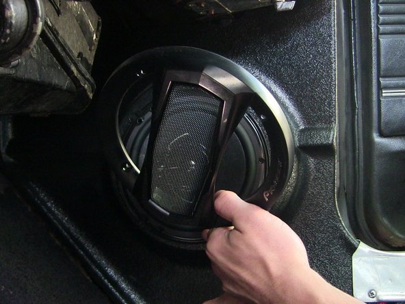

    • The speaker guard and speaker are now ready to be removed.
    • Be careful when removing the speaker. Do not pull the wires tight.

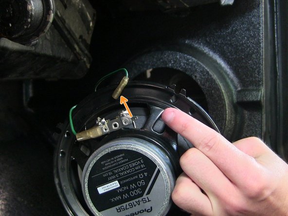

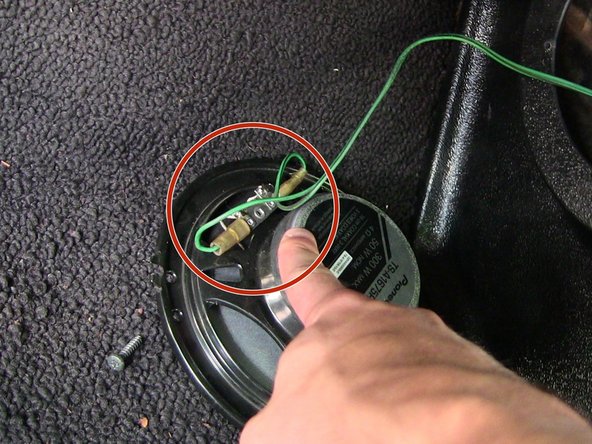

    • Locate the wires on the back of the broken speaker.
    • Remove both the positive and negative wires.
  7. 1967-68 Mustang Kick Panel Speaker Replacement: crwdns2935265:07crwdnd2935265:01crwdnd2935265:02crwdne2935265:0 1967-68 Mustang Kick Panel Speaker Replacement: crwdns2935265:07crwdnd2935265:02crwdnd2935265:02crwdne2935265:0

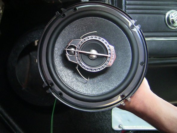

    • Now locate the new speaker.
    • Slide the positive and negative wires onto the speaker terminals.

    • Place the speaker back into the kick panel housing.
    • Line up the speaker holes with the existing holes in the kick panel.
    • Be careful not to pinch the speaker wires.
    • This would be a good time to replace the speaker wires if needed

    • Place the speaker guard back over the speaker.
    • Screw in all four screws
    • Do not over tighten the screws or the holes will strip out.
