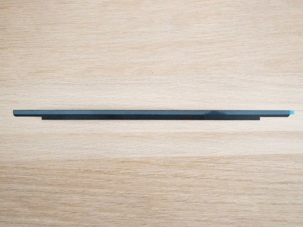

  3. 13” & 15” Retina MacBook Pro Glass Bezel Replacement, Apply The New Bezel: crwdns2935265:03crwdnd2935265:01crwdnd2935265:03crwdne2935265:0 13” & 15” Retina MacBook Pro Glass Bezel Replacement, Apply The New Bezel: crwdns2935265:03crwdnd2935265:02crwdnd2935265:03crwdne2935265:0 13” & 15” Retina MacBook Pro Glass Bezel Replacement, Apply The New Bezel: crwdns2935265:03crwdnd2935265:03crwdnd2935265:03crwdne2935265:0
    • Simply attach the bezel onto your Macbook and use the rubber seal that surrounds the screen to align the bezel.
    • Depending on where you purchased your replacement bezel from, you may not have double-sided tape pre-applied. If not, put a strip of double-sided tape on the top edge of the bezel.
    • The double-sided tape that Apple uses on the bezel is 4mm. I'm not 100% sure but this could make sure the tape doesn't stick to the delicate ribbon cables.

I followed this guide and when I turned my laptop on I had lines all over the screen. Something behind that bezel pertaining to the screen operation exists and it SHOULD HAVE BEEN WARNED ABOUT!! misleading article!!
M IamSneakySteve - crwdns2934203:0crwdne2934203:0
see my comment below for future reference.
Thomas Goldscheck -
Save yourself the possibility of lines in the LCD, just clean up any excess glass and apply the new bezel over the existing. There is glass under the bezel and cables that even the slightest strain will cause lines. If lined up correctly the second bezel is unnoticeable and does not cause clearance issues.
Thomas Goldscheck - crwdns2934203:0crwdne2934203:0
did it have any issues closing after a while? and did you just apply it with the adhesive mentioned in the article? let me know asap!
Asha Singh -
Anyone else who have done it this way with success? What could potentially be the downsides to this simpler method?
