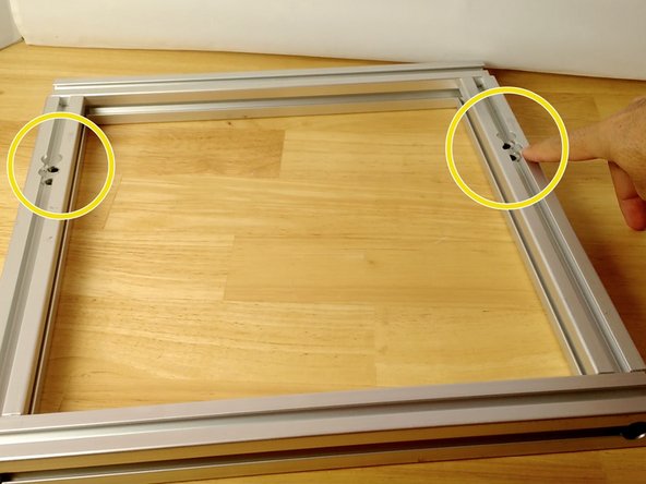

  2. 1. Y Axis Frame: crwdns2935265:02crwdnd2935265:01crwdnd2935265:03crwdne2935265:0 1. Y Axis Frame: crwdns2935265:02crwdnd2935265:02crwdnd2935265:03crwdne2935265:0 1. Y Axis Frame: crwdns2935265:02crwdnd2935265:03crwdnd2935265:03crwdne2935265:0
    • Make sure the sockets for the screws are aligned and in the same side.
    • Using the M8 x 40 screws, join the X and Y members
    • Tighten just enough to keep the frame assemble together.

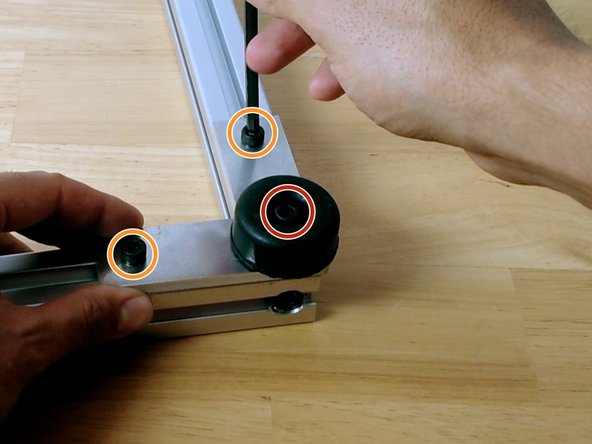

    • Locate the bottom of the frame, where the socket for the head of the screw is drilled.
    • On the L bracket place
    • 2 M6 x 12mm screws
    • 1 M6 x 20mm screw
    • Align on the extrusion and tighten the screws
