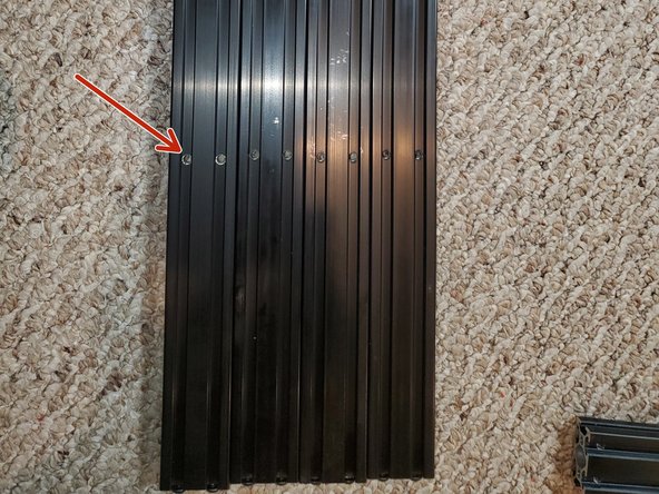

      • Take 2 560mm and 1 496mm 2040 extrusions. Make sure you pay attention to where the holes are on the sides of the extrusions for the M6 screws that are part of the blind joint mounting.
      • Thread 4x M6x16mm button head screws into the threaded holes on the end of the 496mm 2040 extrusion so there's a gap of about 2-3mm.

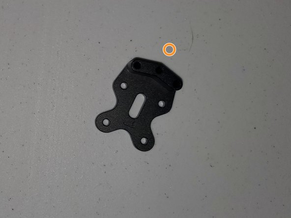

      • Using 4x M3x8 socket head screws mount the LEFT Y MGN mount to the MGN carriage paying attention to the L and the R on the plate.

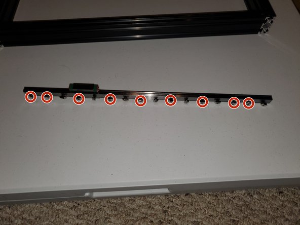

      • Using 9x M3x8 socket head screws and 9x M3 T-Nuts drop the M3x8 screws into the holes of one of the 400mm linear rails. Now remove the 2 red stoppers making sure the carriage doesn't slide off the rail. Thread the M3x8 screws into the T-nuts enough so they don't fall off.
      • When you get to where the MGN carriage is, slide it out of the way to get to those holes. Line up the linear rail so the T-nuts drop into the inside channel of the 2040. Using the picture attached as a reference

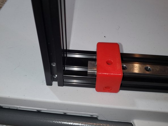

      • Attach 1x 2040 linear rail placement guide at each end of the rail. Keeping the same orientation as the picture with the linear rail in the channel farthest away from you, set the gap from the inside edge of the 2040 to the linear rail to 25mm.(Yellow arrow).
      • Since this is for the left side the Y MGN mount should have a L on it. The linear rail should be in the channel farthest away from you and the 25mm gap should be to your left
      • Tighten the screws roughly 1/4 to 1/2 turn working your way down the rail. Remove the placement guides

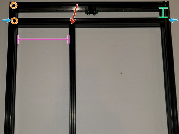

    5. 1. Frame Assembly, Frame Assembly Sides-Left Z 1: crwdns2935265:05crwdnd2935265:01crwdnd2935265:03crwdne2935265:0 1. Frame Assembly, Frame Assembly Sides-Left Z 1: crwdns2935265:05crwdnd2935265:02crwdnd2935265:03crwdne2935265:0 1. Frame Assembly, Frame Assembly Sides-Left Z 1: crwdns2935265:05crwdnd2935265:03crwdnd2935265:03crwdne2935265:0
      • Take 4x 6x16mm button head screws and thread them into the threaded center holes of the 442mm 2040 leaving 2-3mm of head clearance.
      • Take 2 496mm 2040 with the holes drilled along the channel. Slide the 442mm 2040 into the extrusion lining up the heads of the button head screws with the holes along the face(red arrow). Do not tighten the screws all the way.
      • Once you have the 2x 496mm 2040+442mm 2040 assembled thread 8x 6x16mm button head screws into the threaded holes of the 496mm 2040 leaving 2-3mm of gap
      • Using the picture as a reference, slide the 2x 296mm 2040+442mm 2040 assembly into the partial left side frame from step 4. The orange circles will go towards the front of the printer(same corner that had the 25mm gap for the linear rail).
      • Set the gap from the underside of the top 496mm 2040 to the 496mm 2040 directly on top of the 442mm 2040 to 36.8. When the gap is straight and at 36.8mm tighten the 4x M6x16mm button head screws(blue arrows)
      • The gap for the purple line should be 178.8mm(you can use the jig provided in the download). Tighten down the top 2x M6x16mm button head screws(red arrow).

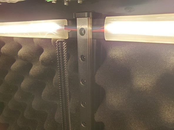

      • The LED wires are meant to go behind the linear rail in the frame channel. I decided to wait to install them to prevent damage during assembly. If you don't want to remove the Z linear rails at a later point, now is the time to install he LEDs

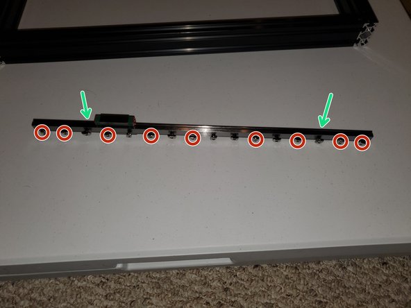

      • Take 1 400mm linear rail. Insert 9x M3x8 socket head screws into the holes. Do not put a screw in the top hole(blue circle)
      • Thread 9x M3 T-nuts onto the M3x8 screws enough so they won't fall off.
      • Align the linear rail so the T-nuts drop into the channel on the 20mm face of the 442mm 2040.
      • The top of the linear rail should be flush with the face of the 496mm 2040. Using 2 2020 linear rail guides, start at the top and work your way down the linear rail tightening the M3 screws so they're snug
      • Once all M3x8 screws are snug go back and tighten them 1/4-1/2 turn to tighten them completely.

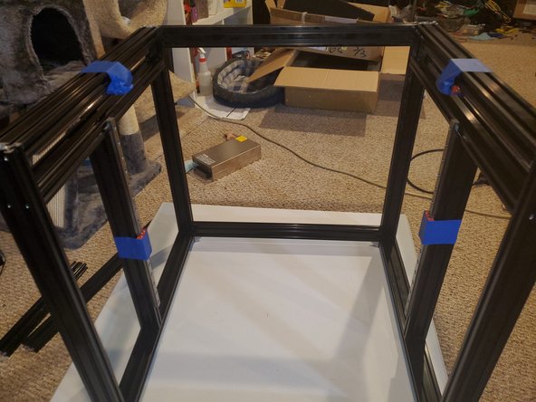

    10. 1. Frame Assembly, Frame Assembly Sides-Join Left & Right: crwdns2935265:010crwdnd2935265:01crwdnd2935265:02crwdne2935265:0 1. Frame Assembly, Frame Assembly Sides-Join Left & Right: crwdns2935265:010crwdnd2935265:02crwdnd2935265:02crwdne2935265:0

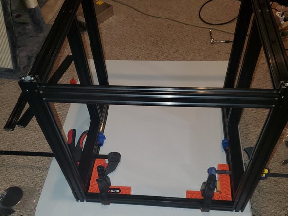

      • This is critical: Make sure your joints are 90 degrees. If your frame isn't straight it will lead to printing and quality issues. It is wise to have someone help you
      • The main picture is of the assembled frame upside down with the front opening closest to you
      • Take the 3x remaining 496mm 2040 and thread 12x M6x16 button head screws into the threaded holes leaving 2-3mm of head clearance.

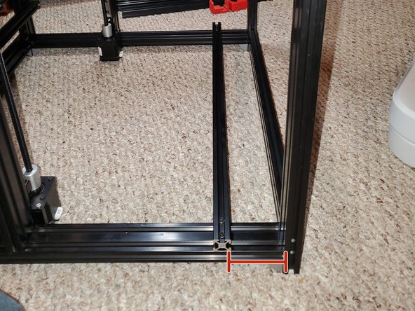

      • Identify the front corners. Along the front there will only be 1x 496mm 2040 along the bottom of the front of the printer
      • Using your corner jigs clamp the left side, right side and cross supports together.
      • To make it easier because I was doing the cross beam for the back top first I slid the 496mm 2040 that was for the front bottom to the front top(where the orange circles are) and tightened the button head screws.
      • Once the back top was done I tightened the back bottom. The 496mm 2040 should be 20.2mm from the edge(blue line)
      • With the back complete, loosen the 496mm 2040 cross support and move it from the front top to front bottom. Make sure the blue line gap is 20.2mm. When everything is square and the dimensions are correct tighten down the 4 button head screws

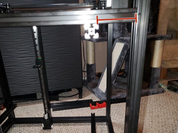

      • Take one of the 576mm 2020 extrusions and insert 4x M5x8 button head screws. Thread on 4x M5 T-nuts enough so they don't fall off.
      • Insert the T-nuts into the channels on the back face of the front of the picture. The distance from the bottom of the 2020 to the top of the 2040 should be 45mm(blue line)
      • Take another 576mm 2020 extrusions and insert 4x M5x8 button head screws. Thread on 4x M5 T-nuts enough so they don't fall off.
      • Insert the T-nuts into the channels on the top face of the bottom 496mm 2040. The distance from the back of the 2020 to the front of the 2040 should be 60mm(blue line)
      • Repeat the previous 2 steps to add the cross support to the top
