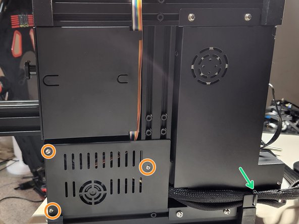

    • On the top of the electronics enclosure remove the 2x M3x6 button head screws with a 2mm allen wrench.
    • On the bottom remove the 3x M3x6 button head screws with a 2mm allen wrench.
    • Now is also a good time to cut that zip-tie.
    • Remove the 2x M5x12 button head screws on the front of the extrusion was a 3mm allen wrench.
    • Disconnect the wires as needed to remove the mother mounting plates.

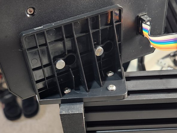

    • Remove the 3x M4x10 button head screws with a 2.5mm allen wrench removing the LCD and mounting bracket.

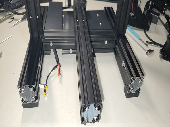

  8. 1. BLV Ender 3 V2 Disassembly, Final Results: crwdns2935265:08crwdnd2935265:01crwdnd2935265:03crwdne2935265:0 1. BLV Ender 3 V2 Disassembly, Final Results: crwdns2935265:08crwdnd2935265:02crwdnd2935265:03crwdne2935265:0 1. BLV Ender 3 V2 Disassembly, Final Results: crwdns2935265:08crwdnd2935265:03crwdnd2935265:03crwdne2935265:0
    • It's a good idea to remove the PSU entirely. Remove the 4x phillips screws.
    • This is how your frame should look at this point.

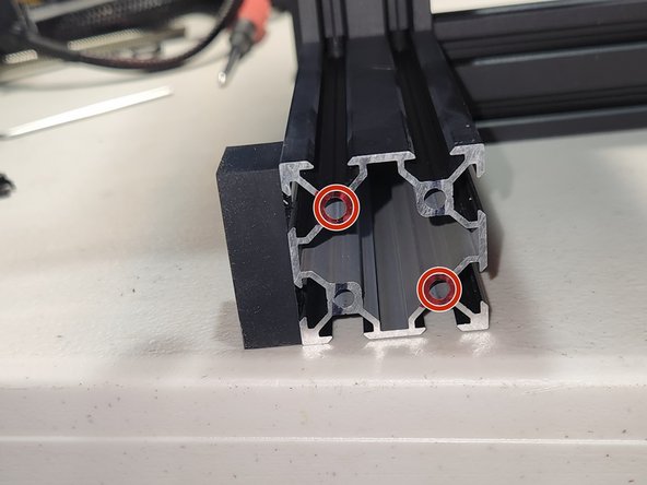

    • If you're going to be using my SKR3 EZ mount you will need to tap these 2 holes on the right front side of the 4040 extrusion with a M5 tap.
