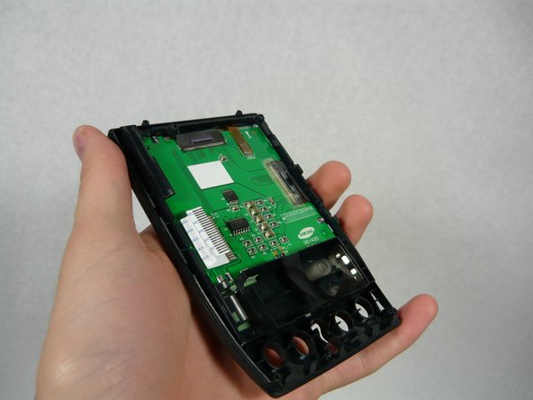

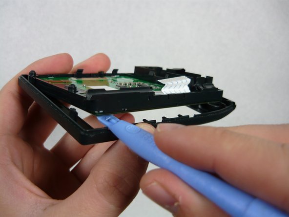

  6.  Palm IIIxe Screen Replacement: crwdns2935265:06crwdnd2935265:01crwdnd2935265:03crwdne2935265:0  Palm IIIxe Screen Replacement: crwdns2935265:06crwdnd2935265:02crwdnd2935265:03crwdne2935265:0  Palm IIIxe Screen Replacement: crwdns2935265:06crwdnd2935265:03crwdnd2935265:03crwdne2935265:0
    • Take the plastic opening tool and gently pry the circuit board out of the plastic tabs around the perimeter located as shown.
    • You must also pry the circuit board away from the battery case (picture 2).
    • Now gently lift up the circuit board from the right side and set it on the cloth.
    • Remember, when reinserting the circuit board, insert it under the left tabs at an angle then gently press the right side down. (picture 3) Also keep the serial tab out of the way.

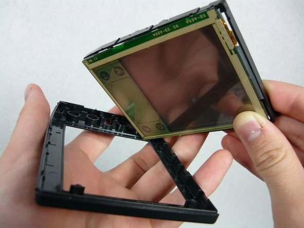

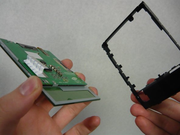

  8.  Palm IIIxe Screen Replacement, Screen: crwdns2935265:08crwdnd2935265:01crwdnd2935265:03crwdne2935265:0  Palm IIIxe Screen Replacement, Screen: crwdns2935265:08crwdnd2935265:02crwdnd2935265:03crwdne2935265:0  Palm IIIxe Screen Replacement, Screen: crwdns2935265:08crwdnd2935265:03crwdnd2935265:03crwdne2935265:0
    • Use the ipod opening tool to pry the cover from the internal plastic frame; the internal frame and screen will come off at the same time.
    • This can also be done with just your fingernails if you wish.
    • Place the front cover aside.
  9.  Palm IIIxe Screen Replacement: crwdns2935265:09crwdnd2935265:01crwdnd2935265:02crwdne2935265:0  Palm IIIxe Screen Replacement: crwdns2935265:09crwdnd2935265:02crwdnd2935265:02crwdne2935265:0
    • The screen and internal frame should come apart easily. Set the screen on the cloth.

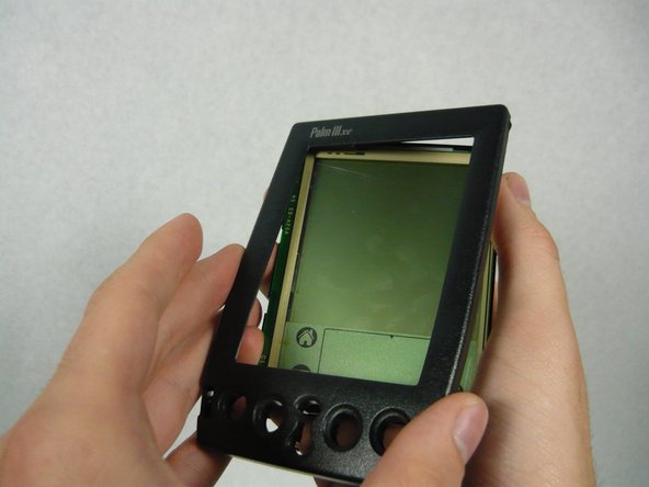

  10.  Palm IIIxe Screen Replacement: crwdns2935265:010crwdnd2935265:01crwdnd2935265:03crwdne2935265:0  Palm IIIxe Screen Replacement: crwdns2935265:010crwdnd2935265:02crwdnd2935265:03crwdne2935265:0  Palm IIIxe Screen Replacement: crwdns2935265:010crwdnd2935265:03crwdnd2935265:03crwdne2935265:0
    • For reassembly: Take the frame/screen assembly and line up the top left corner of it to the corresponding corner of the front cover. (two views shown)
    • Be careful not to tilt the screen too much as it will fall out of the plastic frame.
    • Now press the two parts together. Once together keep the screen facing down because it may fall out again.
