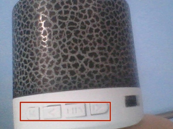

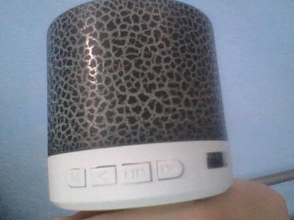

    • The Device you see may look similar to one you may already have, but before you continue, I would like to say that this device is a Generic, low quality Bluetooth Speaker. If you are unsure if this is the speaker you have, then check the manual [If you still have it!] Is is poorly translated or not written right? If the answer is Yes, then this is it.

  4. "Soundwave" Generic No-Name Speaker, How to use: Bluetooth: crwdns2935265:04crwdnd2935265:01crwdnd2935265:02crwdne2935265:0 "Soundwave" Generic No-Name Speaker, How to use: Bluetooth: crwdns2935265:04crwdnd2935265:02crwdnd2935265:02crwdne2935265:0
    • Filp the power switch On. Wait until the device says "Bluetooth Mode".
    • On your smart device with Bluetooth, turn Bluetooth on, and look for your speaker's name. Commonly, these go by BT SPEAKER.
    • If you can't find it, turn the device off and note what BT options you have on your device. Turn it on again, and you should spot the speaker.
    • To control your Device using the speaker: Hold Back to lower volume, Press Play/Pause to Play or Pause the sound, Hold Forward to raise volume, Press Back or Forward to change songs.
