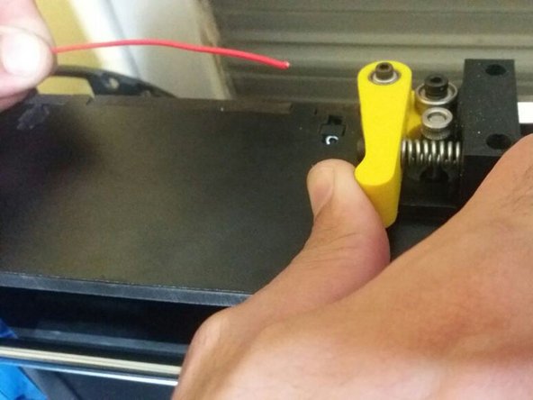

  3. "Replace Filament" Function (During Printing), Removing the old filament: crwdns2935265:03crwdnd2935265:01crwdnd2935265:02crwdne2935265:0 "Replace Filament" Function (During Printing), Removing the old filament: crwdns2935265:03crwdnd2935265:02crwdnd2935265:02crwdne2935265:0
    • Press the ear and pull the filament out of the extruder.

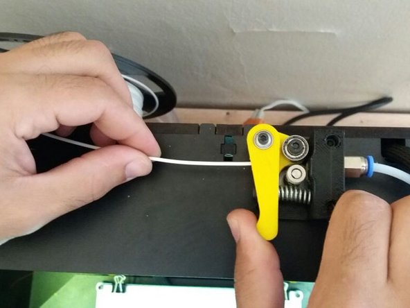

  4. "Replace Filament" Function (During Printing), Placing the new filament: crwdns2935265:04crwdnd2935265:01crwdnd2935265:03crwdne2935265:0 "Replace Filament" Function (During Printing), Placing the new filament: crwdns2935265:04crwdnd2935265:02crwdnd2935265:03crwdne2935265:0 "Replace Filament" Function (During Printing), Placing the new filament: crwdns2935265:04crwdnd2935265:03crwdnd2935265:03crwdne2935265:0
    • Press the extruder ear and push the filament through the hole.

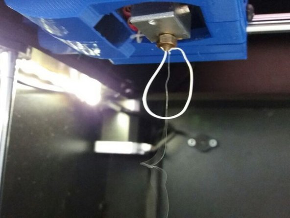

    • Continue pushing the filament until it comes out of the already heated nozzle.
  5. "Replace Filament" Function (During Printing), Finishing and resuming printing: crwdns2935265:05crwdnd2935265:01crwdnd2935265:01crwdne2935265:0
    • Clean the replacement material in the nozzle and press the side button to end the filament exchange and resume printing.
