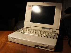

Toshiba sold the T series of personal computers to markets outside Japan from 1981 to 1995. They started with the T200, T250, T300, and T100 desktop computers, which were essentially rebrands of their domestic-market Pasopia models. From the mid-1980s onward, the T series was comprised mainly of portable computers and laptops, like the T2400CS. In November of 1994, it was listed on an advertisement in the PC Magazine for $2,877.59 or $3,039.89 (250 or 320 MB hard drive), which equates to roughly $6,000 or $6,400 in 2024 (via the BLS CPI inflation calculator). This puts into perspective how unattainably expensive these portable computers were in their early days; they were certainly not a household appliance like they are now, being just a luxury for wealthy businesspeople.
Identification
The T2400CS can be identified by a sticker on the bottom of the unit. The sticker should read "T2400CS/250 SYSTEM UNIT" or "T2400CS/320 SYSTEM UNIT" depending on hard drive storage size. The final number of the model number (PA115X) also changes based on hard drive; 5 designates the 320MB and 4 designates the 250MB.
