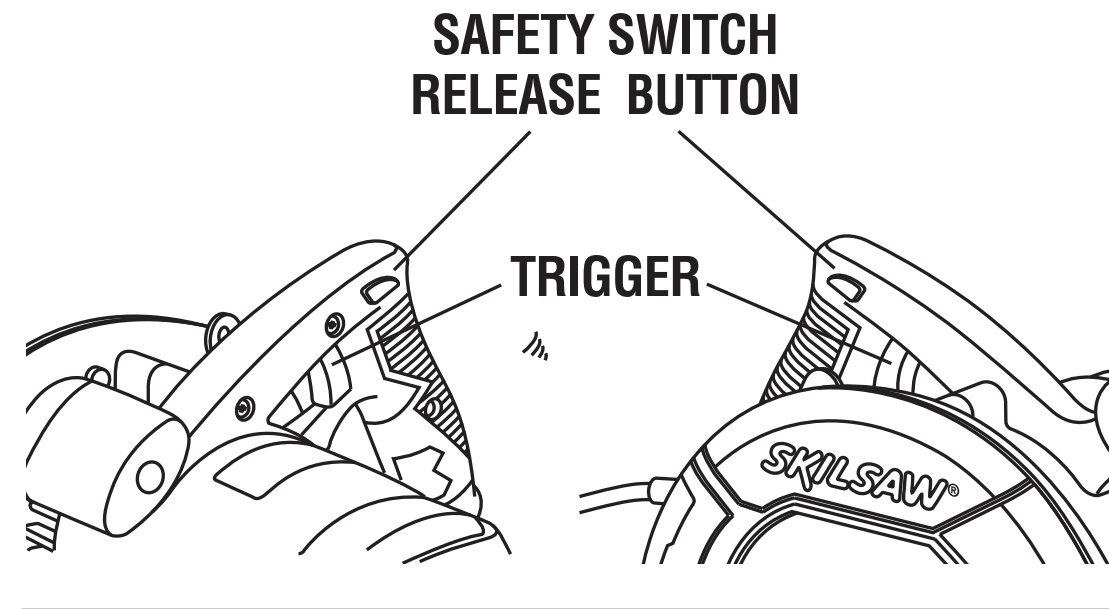

Always wear proper eye, ear, and respiratory protection, then inspect the saw and blade for damage. Be sure you have the correct hand position for the rotation direction you are going to perform. Always use the correct blade, keep guards and motor clean, secure the workpiece, use both hands, stand to the side, let the saw reach full power, cut steadily without forcing, and disconnect power before adjustments. After adjustments, plug in the saw, and you can begin. The safety switch is designed to prevent accidental starts. To operate the safety switch, press the release button with your thumb on either side of the handle to disengage the lock, then pull the trigger.

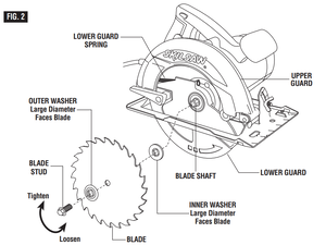

Blade Replacement
  1. Use the wrench to turn the BLADE STUD counter-clockwise and remove it with the OUTER WASHER.
  2. Lift the LOWER GUARD all the way up and check the LOWER GUARD SPRING.
  3. Make sure the blade’s teeth and arrow match the arrow on the LOWER GUARD.
  4. Slide the blade through the slot onto the shaft against the INNER WASHER.
  5. Reinstall the OUTER WASHER, then tighten the BLADE STUD securely with the wrench.
crwdns2916044:0crwdne2916044:0
Do not use wrenches with longer handles, since they may lead to over-tightening of the blade stud
