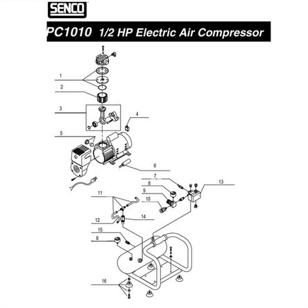

The Senco PC1010 is an air compressor that operates on electricity. Launched in 2004, it is typically used for small construction, home improvement, and hobbyist projects that necessitate the use of compressed air. It has a 1/2 horsepower peak, with a tank capacity of one gallon, and can deliver a maximum pressure of 135 PSI. The air delivery is 0.7 CFM at 90 PSI. It requires a voltage of 115V and an amperage of 4.7A to function. The noise level is 68 dB, and it measures 14 x 13 x 10 inches. It weighs 20 lbs.
The Senco PC1010 is an oil-less, direct drive air compressor with a piston pump, designed to operate quietly and without needing maintenance. It is light and portable, and includes a handle for carrying. The one-gallon tank is suitable for short periods of intermittent use, and the output pressure can be adjusted from 60 to 135 PSI. The unit comes with a 25-foot air hose and multi-purpose air tool accessories, and has a rubber pad at the bottom for stability and to reduce vibrations. The Senco PC1010 can be used for light-duty tasks requiring compressed air, such as operating small pneumatic nailers and staplers, inflating tires and sports equipment, airbrushing artwork or crafts, powering grinders, sanders, and other air tools, and blowing dust out of equipment. Its compact size makes it fit for home workshops, on-site jobs, mobile tire services, and inflatable rental businesses. It is not advised for non-stop heavy-duty industrial applications.
Technical Specifications
  • Power: 1/2 horsepower peak
  • Tank capacity: 1 gallon
  • Maximum pressure: 135 PSI
  • Air delivery: 0.7 CFM at 90 PSI
  • Voltage: 115V
  • Amperage: 4.7A
  • Noise level: 68 dB
  • Dimensions: 14 x 13 x 10 inches
  • Weight: 20 lbs
