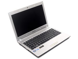

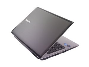

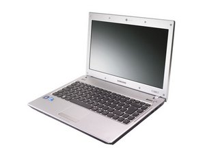

Identification
The Samsung NP-Q330 is a slim laptop made of gray metal with a black keyboard. The left side of the device has a DC Jack, fan vent, monitor port, wired LAN port, HDMI port, USB port, microphone jack, and headphone jack. The right side of the device has the optional CD port, 2 additional USB port, and a security slot. Unlike similar models, the 13.3" Q330 has a centered mousepad with the status indicators and multi-card slot directly in front of the mousepad. The model number can be found under the screen to the right side of the device.
