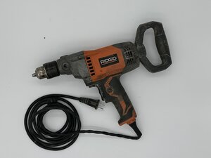

The RIDGID R7122 spade handle drill was released in 2012, and the equipment must be operated only by trained professionals. When purchased, the device comes with a lifetime service agreement saying that they will replace your broken RIDGID spade handle drill within 90 days of purchase. The device will also include one R7122 9 Amp 1/2-inch spade handle mud mixer, auxiliary handle, chuck key, key strap, and operator's manual in the box. Known for its impressive durability and speed, the RIDGID R7122 Drill can be used either as a drill or as a mud mixer. Common issues that are associated with this device are mostly related to worn-out parts that can easily be replaced in order to return the drill to its former glory.
Identification
Physical Description:
  • 8 ft. cord that provides a long reach
  • Hex Grip micro texture for a secure grip and maximum user comfort
  • Lock-on button for your convenience during continuous drilling or mixing
  • Auxiliary Handle
  • Key strap
  • Comes in the colors Orange and Black
  • Has the brand name RIDGID on its left side in bold letters
Some Features Attributed To The RIDGID Spade Handle Drill:
  • 9 Amp motor
  • 5/8 in. spindle
  • Rotating rear spade D-handle that rotates in a variety of orientations
  • 3-position auxiliary handle
  • Forward and reverse direction options via a switch for drilling and backing out jammed bits
  • Lifetime service agreement with registration within 90-days of purchase
  • Model number can be found on side of chassis opposite the label
Technical Specifications
  • Manufacturer: RIDGID
  • Production: Continuous Since 2012
  • Power Source: Power Cord
  • Maximum Speed (RPM): 500 RPM
  • Chuck Type: Keyed
  • Weight: Approx. 6lb
  • Motor: 120V AC, 9 Amps
  • Model #: S13426D
