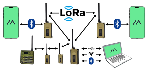

Meshtastic uses the Long Range (LoRa) protocol to facilitate the long range off-grid comminication platform, allowing for supported devices to become nodes in a network, and allowing users to send text messages and sensor data over multiple hops without any cellular or Wi-Fi infrastructure. If the message hasn't been recieved by another nearby Meshtastic device after a certain amount of time, it will attempt to retransmit the message.

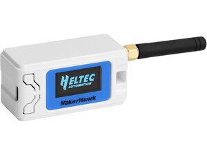

  • Microcontrollers: Most nodes with low-power MCUs
  • LoRa Transceiver: SX1262 or SX1276/SX1278
  • GPS Receiver: GNSS
