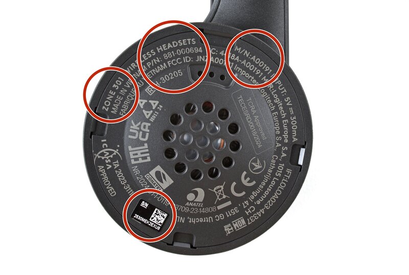

Identification
The Model Name, Model Number (M/N), Part Number (P/N), and Serial Number (S/N) are found under the right ear pad. The Zone 301 has M/N A00191 and the graphite color has P/N 881-000694.
