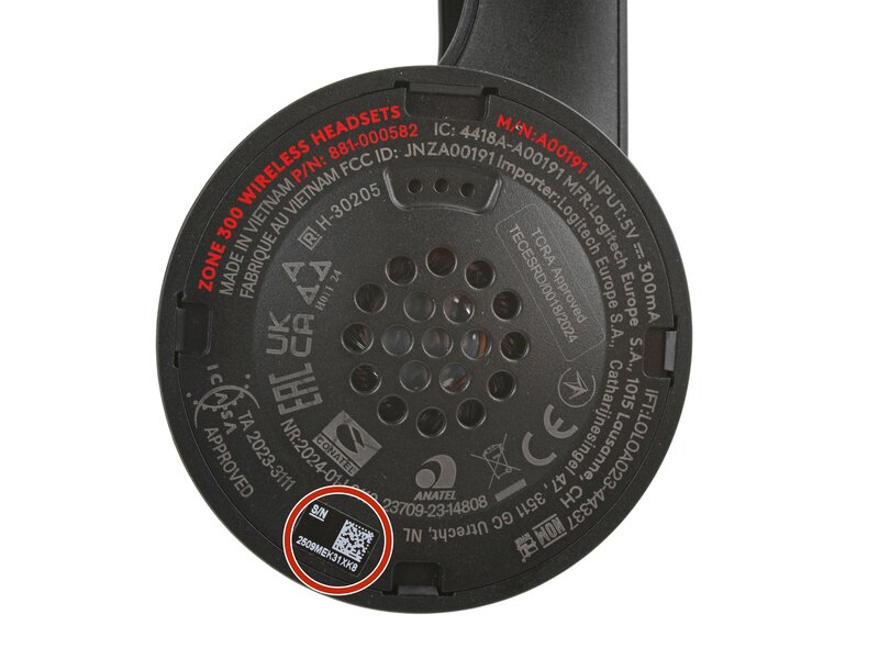

Identification
The Logitech Zone 300 headset is available in the following colors, along with their corresponding part numbers:
Midnight Black (Part number (P/N) 981-001406)
Rose (Part number (P/N) 981-001411)
Off-white (Part number (P/N) 981-001416)
The Logitech Zone 300 headset can also be identified by its model number, M/N A00191.
The headset name, Part Number (P/N), Model Number (M/N), and Serial Number (S/N) can be found under the left ear pad.
