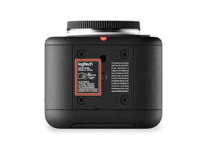

The Mevo Core stands out with its cube-like form factor, matte black finish (the only color option), and prominent 3.5-inch diameter body. Unlike other Mevo cameras, the Core features a Micro Four Thirds lens mount, allowing for lens swapping—a first for the line. The back has multiple ports including USB-C, HDMI, 3.5 mm TRS, and microSD. The power button with a four-LED battery gauge is located on top, and the bottom and sides feature multiple ¼-20 mounting threads, including anti-torque support.
If your device powers on, you can identify it through the Mevo app or by checking system info via HDMI or streaming software.

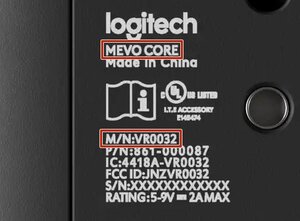

Physical identification is easiest by the information printed on the bottom, which says Mevo Core and should also list the model number (M/N), which is VR0032.
