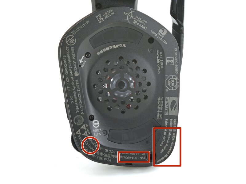

Identification
The G535 headset has Part Number (P/N) 881-000456 and Model Number (M/N) A00140. The headset name, Part Number, and Model Number can be found under the left ear pad. The headset comes in black only.
