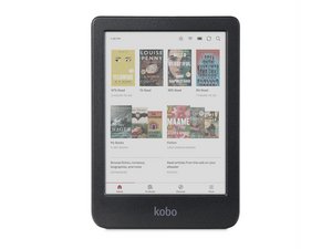

The Kobo Clara Colour (N367B) is a mid-cycle refresh for 2024's N367 model of Clara Colour, featuring a larger battery and slightly redesigned internals.
The Kobo Clara Colour is Rakuten Kobo’s first eReader with a color display, along with its partner device, the Kobo Libra Colour. Offering 16 GB of storage, the Kobo Clara Colour inhabits the same lightweight form factor as its predecessor, the Kobo Clara 2E, but replaces the 6” black and white display with a 6" color E Ink Kaleido 3 touchscreen that allows for a full spectrum of color—without losing that classic E ink look. Moreover, it supports Kobo Audiobooks with a wireless Bluetooth device, along with IPX8 waterproofing for any poolside reading.
For nighttime reading, the Kobo Clara Colour features an optional Dark Mode, plus the built-in ComfortLight PRO to adjust brightness and reduce blue light. As part of Kobo’s ongoing commitment to sustainability, the Clara Colour is made with recycled and ocean-bound plastic. The Kobo Clara Colour starts at $149.99 USD.

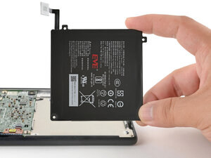

The Kobo Clara Colour (N367B) uses different batteries from different suppliers. You can tell which battery you have by the 7th digit of the serial number:
  • "3" or "7" — 1900 mAh, made in China
  • "4" or "8" — 1900 mAh, made in Taiwan
