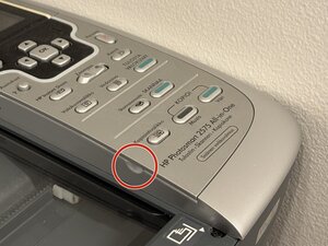

The HP PhotoSmart 2575 All-in-One Printer can be identified by the product number Q7215B and is colored in dark grey/blue and silver along the top. The HP logo is located on the top of the printer, and the buttons and screen are located on the top right of the machine.
