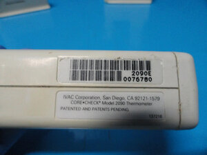

The IVAC Core-Check 2090 thermometer is a rectangular plastic body with a handheld section and a screen on top where the temperature is shown. The tip in the front should be covered with a new ear shield for hygiene before use with a patient. The home base is plastic and has a section for the thermometer and the dispenser. The dispenser is where the ear shields (model P90) are stacked to help prevent cross-contamination.
The thermometer model is on the back side or underside that reads: Model 2090-Alarais Medical Systems.
Image Source: Check Core 2090 Ebay listing
