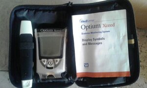

Identification
The Abbott Optium Xceed is a specially designed glucometer. It is a lightweight and compact machine, which is designed ergonomically. It has a simple icon drive menu, with simple use buttons and does not require any manual coding before or during use. It has a large display screen. There is a three-button row right below the screen.
The colour scheme for this device that can be confirmed from the pictures is a silver or grey front with a black bezel. The model's box should clearly say "Optium Xceed" on the front. If the box label is "FreeStyle Optium" or "Optium", it is a new or a different model. The side of the box also confirms the type of strips that are used with the machine.
It comes in an easy to carry case, the device also has lancets available for purchase. There are two types of testing strips, the blue ones are for glucose monitoring, and the purple ones are for monitoring the beta ketones. The dual- monitoring is less common in glucose only monitors.
