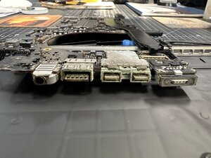

I have scoured the internet trying to find out why both my internal microphone and speakers have disappeared from the input output in sound preferences? I have tried all resets everyone have suggested to do with no luck, I think I have narrowed it down to the i/o board that my 3.5mm headphone jack is connected to, but not sure? Has anyone else had this happen?

@alsadler - This series has the headphone jack on the main logic board, so the I/O board won't be an issue here.
Did you even try plugging in a micro plug speaker or headphone in yet to see it the jack is working? I would start there as that could narrow down the fault.
Did you have a spill into the keyboard? As it's possible the liquid got onto the logic board causing some corrosion. Follow this guide to take it out so you can do a deep inspection looking for signs of damage MacBook Pro 15" Retina Display Mid 2015 Logic Board Replacement. If you see something odd take two picks one nice and tight and in focus and a second backed off a bit so we can ID the location within the logic board. Post them here so we can see them.

@danj Yes I did try, and also because I hadn't used it for some time I tried inserting and removing multiple wired headphones many times to see if the jack was corroded? Sadly yes I did have a spill, but it was after the microphone/speakers had disappeared from the sound preferences. Looking for any damage to logic board now.
@danj So I have the logic board out now and I am seeing some bad green corrosion all around that part of the board. Is there a way I can send you some pics?
@alsadler - You can post them in a fresh answer by clicking on the menu bar far right icon (a landscape picture of sorts) click on the top left button in the toolbox once it's prevent here, you'll need to click on it again to enter its tag into the answer window. Save the answer and convert it to an update, done!
