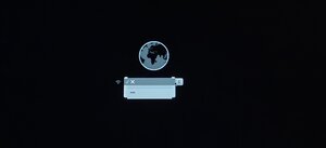

The keyboard and trackpad on my macbook stopped working an in an attempt to resinstall macos hoping it could help fix this, but i erased the startup disk instead....
Now the macbook reboots into internet recovery every time but i can't connect to internet from here, nothing comes up, see the picture.
And i can't seem to turn off the macbook either, it just starts up again into internet recovery again after i turn it off.
What i have tried to get somewhere:
  • All key combinations i could find online, ⌘-R, ⌘-shift-R, ⌘-alt-shift -R. I'm using an external keyboard for this since the built in is still dead. Can't seem to get into any other option.
  • Resetting the PRAM, still not sure if this works since nothing new seems to be happening.
  • connect through ethernet cable to the router, but looks the same with no wifi showing up.
So did i accidentally brick this Macbook or does anyone have any idea on how to proceed?

When you say you reset PRAM, are you sure it actually reset? That's typically what will fix this for me especially if WiFi networks should be available. You can also try resetting SMC, but typically PRAM reset is the trick. I always know that works if the screen blacks out amid boot. SMC is usually harder to tell on this generation of mac if you were successful so you may have to try a few times.
The other thing I would try is to connect this to a physical Ethernet connection if you're able. Internet recovery will also recognize that, but you'll need a USB-C to Ethernet adapter to make that happen. Those are pretty inexpensive if you don't have one already and definitely less than a new MacBook charger for your old one.
Hi, thanks for the reply.
I tried now a few times to reset the PRAM but i don't get the "screen black out" as you mention so not sure if it's working. I am using an external (Non apple) keyboard though USB A to USB C adapter.
I'm rebooting it and pressing "alt, win, P and R" which to my knowledge should be corresponding to the right command for resetting the PRAM. Also tried "Win, alt, right shift" to reset the SMC.
I have an ethernet adapter (also non apple) that I've tried using but still the same blank list in internet recovery mode shows up, could it be some drivers that's not working?
