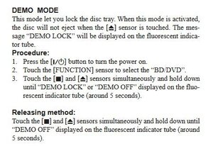

I can't open it and it says locked
Hi @markanthon74337
Does it say Demo Lock perhaps?
Here's an image that shows how to unlock the disc tray when it is demo locked.
