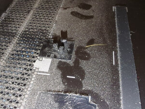

i'm trying to open my laptop to clean the fan, but can't open the lower case.
i'm using this manual
Lenovo IdeaPad 5 (14″, 05) Hardware Meaintenance And Service Manual
that should be the right one as the model is IdeaPad 5 14ALC05 82LM
following the manual first of all it tells to remove 9 screws when my laptop has only 7 (the other two aren't missing, there's 2 fewer holes than described).
anyway i remove every screw, pop all the clips on the 4 sides and now the borders are free to flex upwards and move around a bit, but there seems to be something holding the cover in place, from roughly the center.
Nothing like this is mentioned in the manual and in every tutorial video i looked up the cover just lifts off without effort after popping the clips.
has anyone encountered the same problem?

i figured it out, the answer was to use more force, and helping myself with a ruler.
in my laptop there was an extra latch in the middle that isn't clearly mentioned in the manual and takes a surprising amount of strength to pull open
the part number for the cover is 5CB0Y88536
That looks broken

there was an extra latch i didn't see right in the middle of the cover, looking at it better the same thing is also on the replacement covers in the lenovo store, but i don't think i've seen anyone struggle with it in a video tutorial
