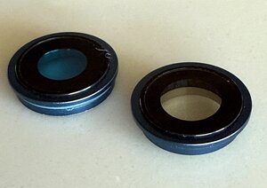

I received the lens covers, but can't remove the bezel?
I received the lens covers, but can't remove the bezel. How on earth do you remove the existing bezel around the camera lens cover (blue ring on the blue iPhone 13 Mini in my case)?
Here's a photo of what I received:
Thanks in advance for your help.

Am I correct in assuming you're trying to replace the glass covering your camera lenses? If you ordered replacement parts, it should simply consist of a circle of glass with adhesive on it. To replace the glass, you would heat the original glass to soften the adhesive, then use something like an X-Acto knife to pry the old glass out. Removing the bezel shouldn't come into the equation at all; they're spot welded in and have to be removed by chiseling them off or possibly using a Dremel type tool to grind them off, neither of which is possible with the back glass still in place.
The upshot is if you're just replacing the glass, taking the bezels off shouldn't come into play.
If I've misunderstood what you're trying to do, please explain why you want to remove the bezels, as it's not something that's usually done for any kind of repair.
Hmm. I was expecting just a lens, but it looks like the part I received has a blue bezel/ring around the glass as well, which looks like the existing bezel needs to be removed somehow. Here's what I bought:

@ojak Are the lenses already installed in the bezels, or are they separate? If they're two different pieces, then you should just use the lenses and toss the bezels; as I said, you can't remove the bezels with the rear glass in place, and even if you could, how do you reinstall them? I don't know about you, but I don't have one of the micro spot welders Apple uses to secure the bezels.
The upshot is the bezels won't help you, and if the glass is already installed in the bezels, you should return them and just go online and search for replacement lenses without the bezels.
