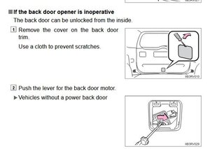

I have a manual lift gate that wont open
Hi @robinmgage
It may be a faulty locking mechanism, try opening it from the inside.
Here's an image from the 2015 owner manual that may help.
