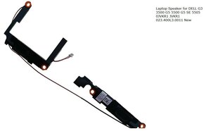

Basically to sum up everything, one side of the speaker is broken(sound kinda like a rattlesnake rattling) and there was no guide on how to change it.
Hi @hourngor
Go to p.28 in the service manual to see how to change the speakers in the laptop.
The speakers come as a set i.e. the left and right speakers are wired together. They cannot be purchased separately - see image below.
Search online for 0JVKR1 to find suppliers that suit you best.
