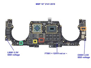

Your MBP has the 820-01700 logic board which has a common failure which is a failing of U9580 TPS6218 buck converter and supplies SSD voltage. If that fails it can create a short to ground of your power rail PPBUS_G3H and may allow 12V to the SSD IC's ,which will be destroyed. That would be a catastrophic failure.
Some quick checks you can perform if you have the skills and a multimeter are to measure Fuse F7001, it must have at least 12V if not or if fluctuate, check L9081, that must have 2.5V. Next measure C9591 which must have 2.5V. If it is less you must suspect U9580 to have failed. Check for short to ground by placing your meter in resistance mode and measure the resistance between L9081 and ground. Let us know what it shows. If there is a short to ground, it will most likely be caused by a failed U9580
Post a couple of well focused pictures of your logic board and specifically of the area where U9580 is located. That way we can see what you see and maybe help you further, if that is the way you want to go. If not, then I would suggest to either have someone that is familiar with board level repair work on it. Since this is a common issue it may have actually destroyed the NAND on your logic board etc, and you may need to consider replacing the logic board altogether. You could determine that by removing U9580 and see if the short to ground has been resolved if yes, replace U9580. If not, then your board had a catastrophic failure and would need some very costly and uneconomical interventions :-)
Again, we do not know your skills, your tools and your resources so this may all just be academics :-)
