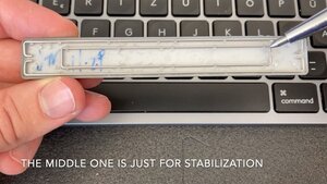

As you had said, it's usually something stuck under the space bar preventing it from being pressed, but it could also be the spacebar stabiliser bar being slightly bent
(photo from a different laptop),
or the button underneath being dirty.
