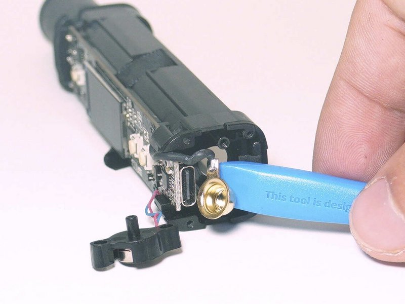

V3 been used daily for 4 months or so and then mid road trip it failed. Won't turn on and when I plug charger in it says charging mode like . If I press 3 times it says see you . But if I press 5 times it says xmax and does load up but then says battery flay warning .
I left it with no battery installed for 24 hrs and it worked fine for one batterys worth . When I replaced it with full battery it went back to broken mode. Seems like firmware . Iv trydd cleaning contacts multiple batterys etc. No luck. Pulled it apart no visible issue reassembled n still same.
Any idea anyone smarter than me?
I just fixed mine with similiar symptoms.
In my case, the wire ripped off the negative pin.
I love how easy this thing is to take apart!
But still, there is the guide to do it.
https://de.ifixit.com/Anleitung/Auseinan...
In this image is the pin. The solder was fine, it ripped just after the the latch.
https://guide-images.cdn.ifixit.com/igi/...
To check if its the case with your device, you can use a DMM in continuity mode and check from the pin to negative wire, on both ends.
