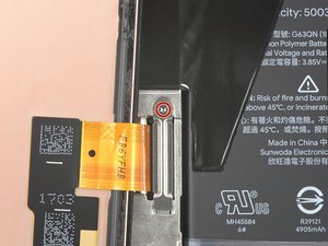

The connector is really the only thing that you can reasonably check. Ordinarily I'd say it's a long shot, but Google changed the design of the display connector retainer on the 7 model. Here's the retainer on my 6 Pro
As you can see, there's a screw holding it down, meaning no amount of impact or force can knock it loose. Contrast that with the retainer on your 7 Pro.

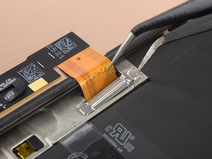

No screw, right? So although it's unlikely, it's not impossible for the retainer to pop out of place. If it has, then the connector underneath is also free to come loose due to being bumped or jarred.
So yeah, open it up and check the connector. If it's popped loose then that's a good indication that you may be able to fix it by reseating the connector and resecuring the retainer. Otherwise go ahead and unplug it and check the connector; use a magnifying glass and a bright light and check both sides for any kind of damage; bent or broken pins in particular. If everything looks good, clean them with 90% or higher concentration isopropyl (rubbing) alcohol, give them a moment to dry, reconnect and test.
