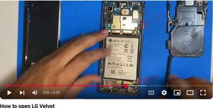

Try using the phone's WiFi as close as possible to your home network router i.e. <10cm and check if it detects and connects to the network and if the connection remains stable.
If it does, there may be an antenna problem in the phone e.g. loose or faulty.
Here's an image taken from this teardown video showing the antenna connections.
(click on image)
