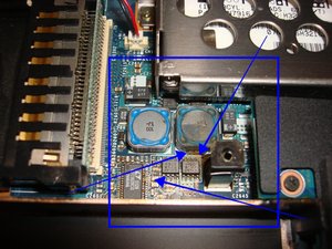

I recently acquired an old Sony Vaio PCG-993L laptop, but when I went to test it out, it shows absolutely no signs of life. I have checked that the power adapter works. Are there any common issues with this laptop not turning on, or what could this problem be? Additionally, I have included some photos of the top of the motherboard.

@leofeldman take a closer look around the area of the inductor. Looks like there is some leakage or spillage. It is also possible that it is just my old eyes. Time to remove the motherboard and to check it closer, then clean it with some 90%+ isopropyl alcohol. Let us know what exact number s are printed on your motherboard. That way we can check for schematics.
@oldturkey03
I have updated my original post to include pictures of the motherboard. Even though I couldn't test current with an ammeter (I couldn't get mine to work), I did feel some warmth around the area where the power adapter plugs into the computer, and once I got it apart, the metal enclosure surrounding the power jack.
