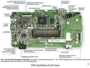

EDIT photo DS original motherboard:
Good afternoon, I removed the motherboard from the shell and I tried test it with some "GOOD" top parts that i obtained fixing others nintendo ds and I discovered that all of them do not play any sound. So I tried test them also with a headphones with jack but is the same… What should i do now? Luca
Hi Luca! So, you took the motherboard from the "No sound DS" and tested it on other DS consoles and there is still no sound?
if this is the case, it probably is the Audio IC.... This one is difficult to fix.
You need soldering experience here to get it fixed.
I'll upload a photo regarding the components on the original DS motherboard, so you can decide if you want to fix it or not!
POST UPDATED.
Can i find this chip in others console like DS Lite? Luca
Yes! It should be on every DS motherboard. If you are in doubt, please share some pictures with us! Thanks!
