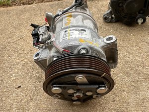

  1. Pop the hood and locate the AC compressor on your vehicle, This will have the two rubber lines with metal connectors on it. It is driven by the serpentine belt on the car so you should be able to see it on the left side of the engine where the pulleys are located. might be at the lower front. It will look like the image below.
  1. Once you have located it, have a friend or significant other start the vehicle with everything off.
  2. Once the vehicle comes to the idle position have them activate the AC and turn it to full.
  3. You should hear the clutch on the AC compressor kick on and start to run. You will also see the clutch engage on the front of the pulley if you are in a position to view it with a flashlight. ( Be careful not to get to close to the serpentine belt. Safety First )
  4. Do you hear the clutch kicking on and off and cycling? or does the car remain the same no increase in idle and no clutch kicking on?

Ok so when I checked the compressor the clutch was engaging and I could hear it coming on and off and was able to see the clutch engaging as well. I will send the cars stats in my next message.
